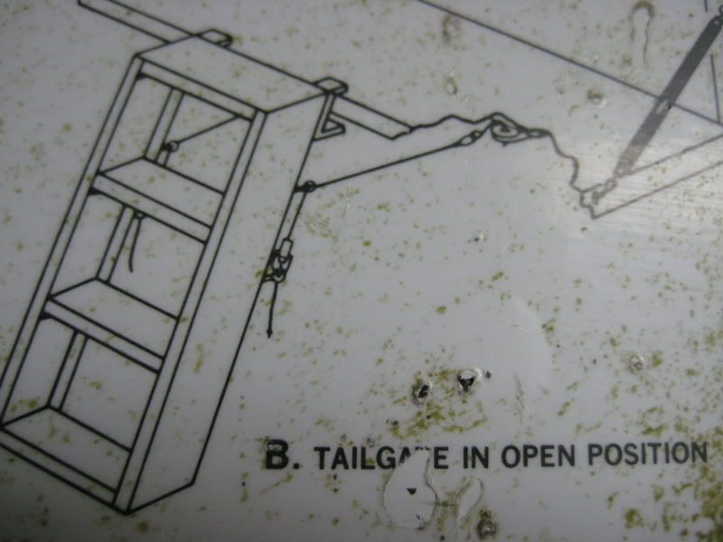

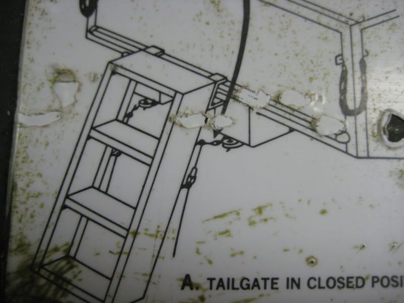

Hi,

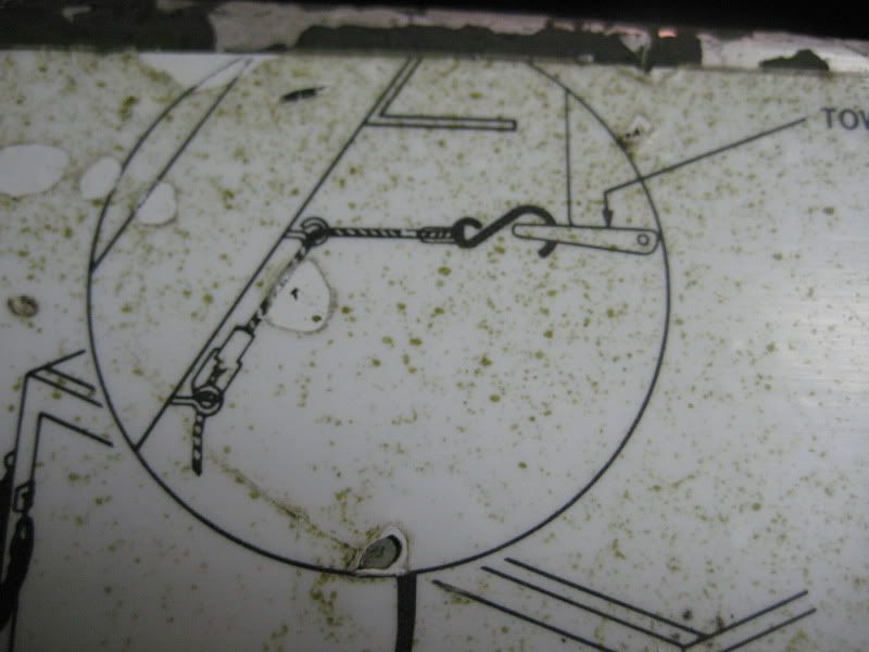

I found another ladder that fit much better and I just looked at your photos and I think it's the same model that you have. Do you know if this was THE ladder for the M-37 or what it's made for? I didn't get the stanchion(s) for it but it has some rope attached to it and the other end of the rope is tied to what looks like metal corks with loops on top of them. Do you know what those are for? I'm thinking that it might be the top of the stanchion.
They are common Como Shelter ladders. I've seen them used in the M880 series with shelters and the Humvee with shelter.
The ropes with metal corks are safety tie-backs that attach to the truck's lifting/towing shackles to keep the ladder from slipping off of the tailgate when tentioned correctly. The metal corks are adjusters and lock the rope when tight, holding the ladder in place.
