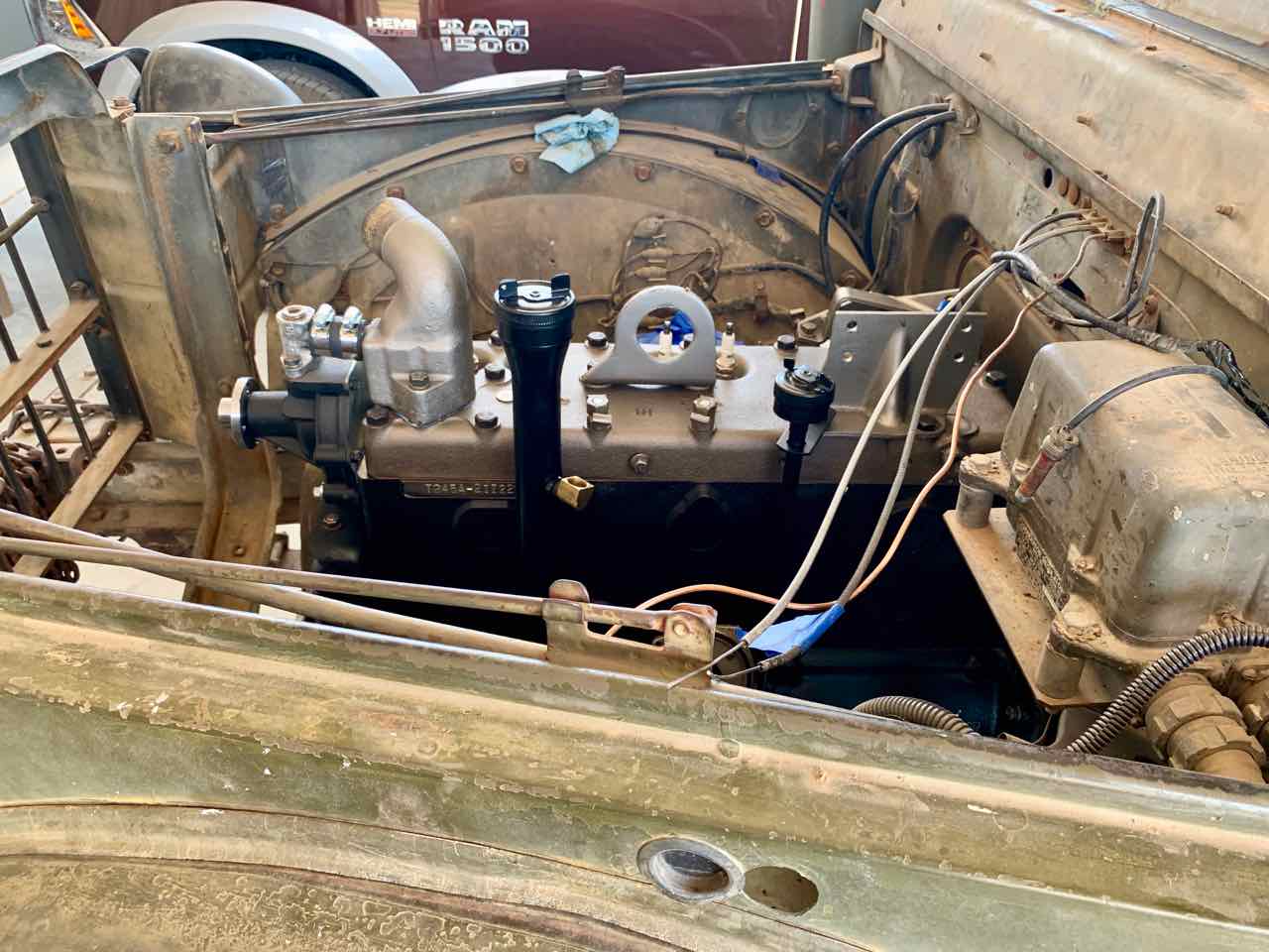

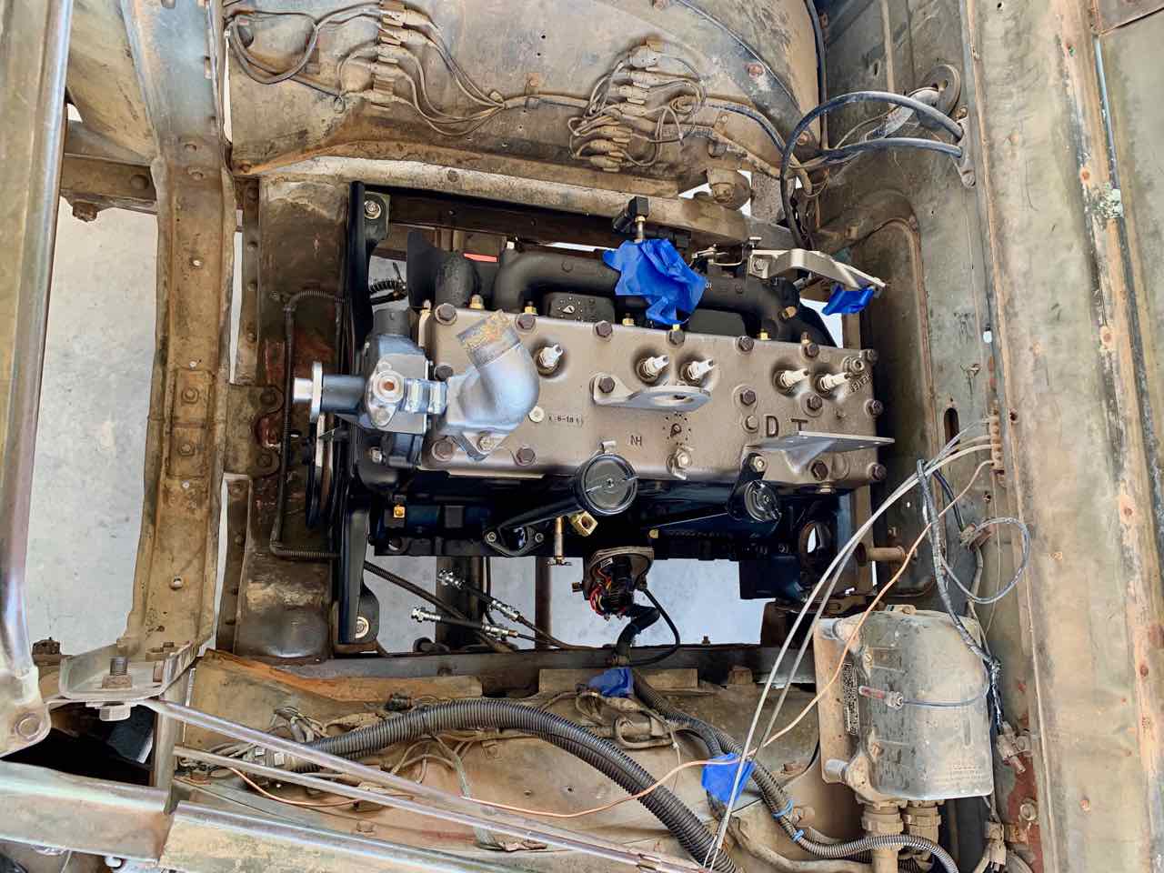

The cherry picker lifted the engine nearly level, no issues with the connection to the bell housing.
It is coming along. More work to be done.

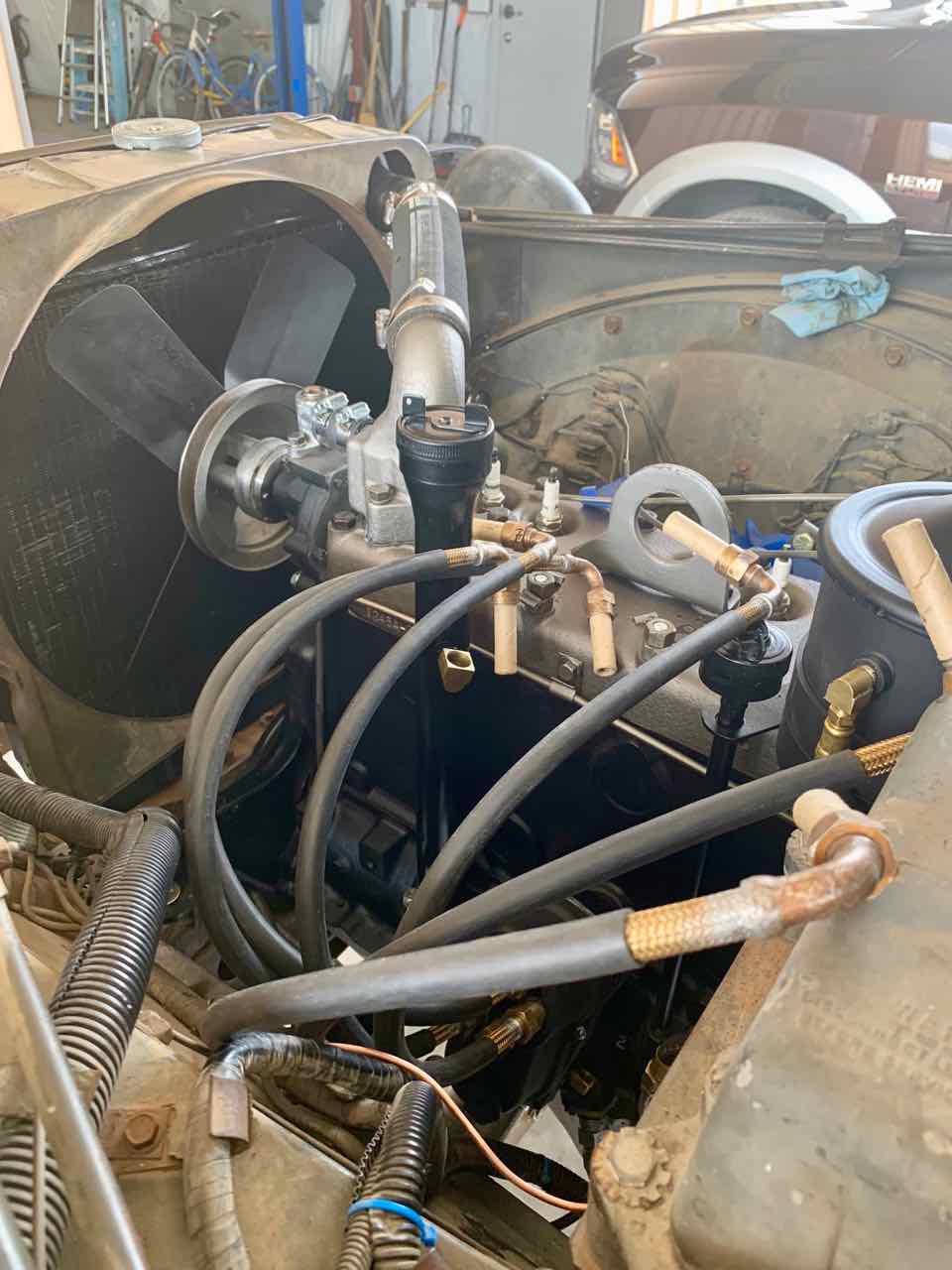

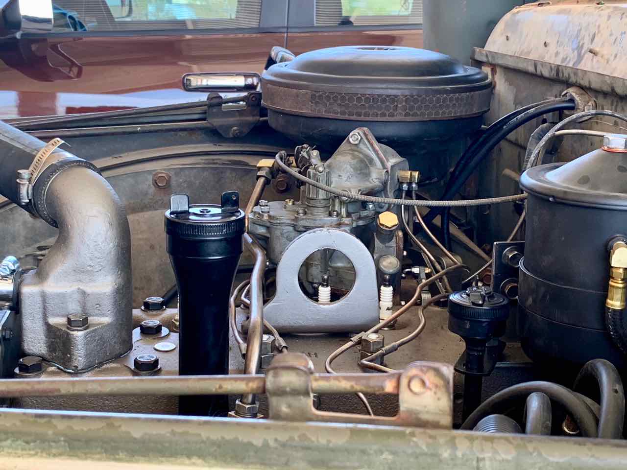

Some more done today. Carburetor is on, vent lines.

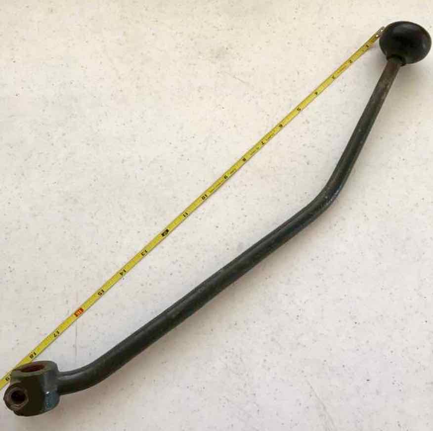

My newly acquired NP 420 4 speed has a very tall and long stick shift. The stick hits the bottom of the dash in first and neutral.
Need to do some mods to get it to fit and function. Would like to find a stick like this one:

Heat & bend, then cut off and use a 3/8" fine die on it.
The long shifter was issued on the early trucks.

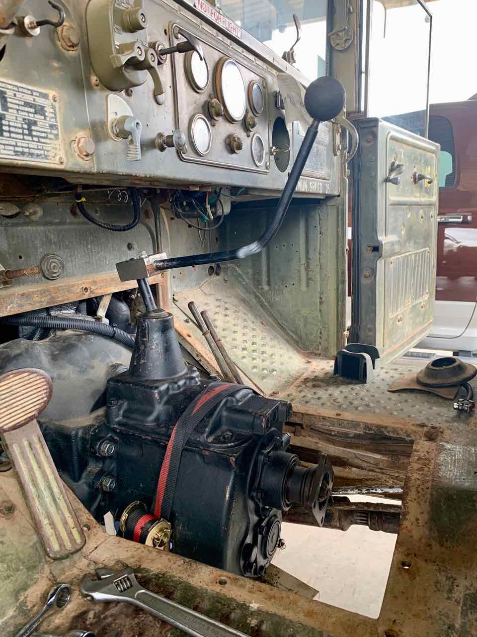

Cut the long stick shift and fabricated a mounting block. Heated and bent the stick to fit above the seat. This seems to work well.
The heat and humidity with dew points in the 60's are limiting my time on the truck. The Porta-Cool effectiveness has dropped significantly due to the monsoon weather.
