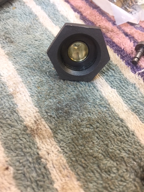

I finally collected everything I needed to repair the atmosphere valve of the Hydrovac.
Here is the valve body. You can't see it but there are pits in the cylinder.
So off to the milling machine to ream out to make it over sized.
I picked a piece of seamless brass tubing that was just a little larger than the reamer size.
I put the valve in the oven to heat it up while the brass tube went into the freezer.
Then I forced the cold brass tube inside the valve body.
Then once totally cool, back to the milling machine to ream the brass to the correct size and then polish with a 1500 grit paper.
