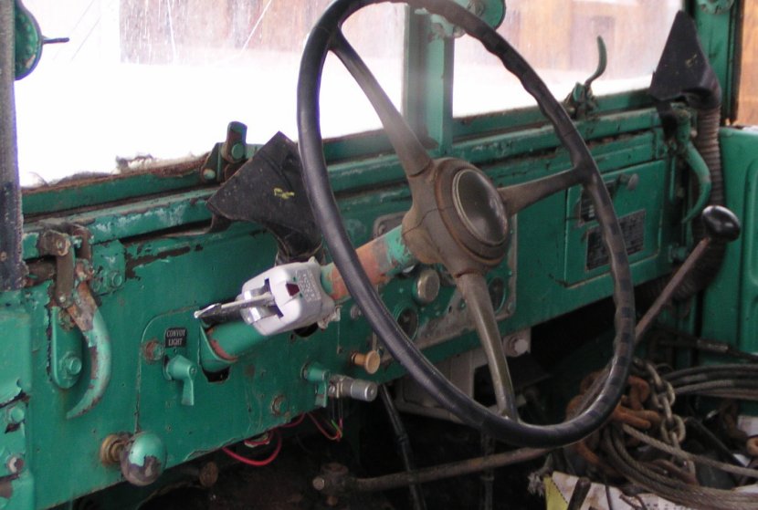

I agree with that fact that the push button shifters' buttons stick. Also the push buttons had a lever to engage park. That one used 2 cables. The trans would have to be one to accept it. I have a 518 trans that has electric overdrive so I can use the one cable 3 position shifter. I have an overdrive off button somewhere on the dash just like the 1992 Ddodge had. I personally prefer this shifter's look even though it may seem odd in a M37. It is still a "Dodge" part. I am going to brainstorm a defroster system next. I'll try to make a neat duct to each side. I did not like the awfull aftermarket one it had. here is a pic of the original dash.

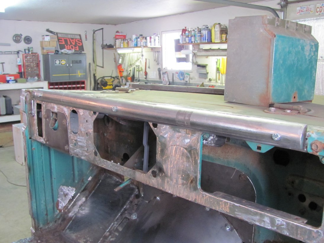

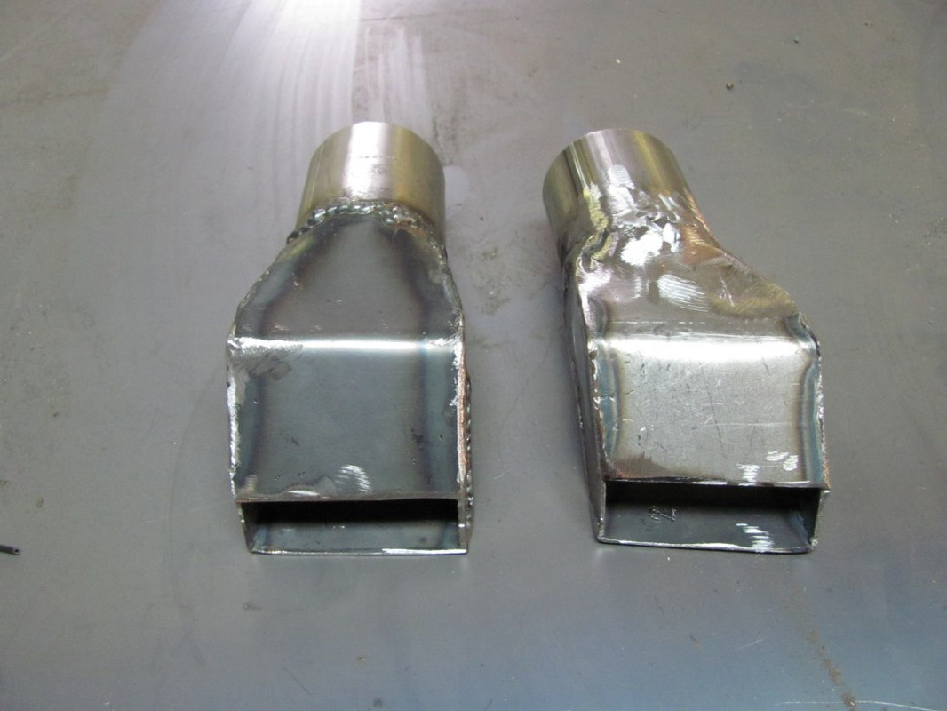

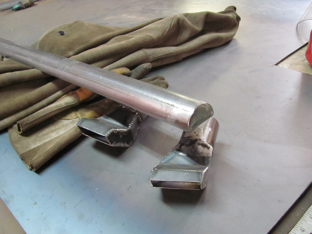

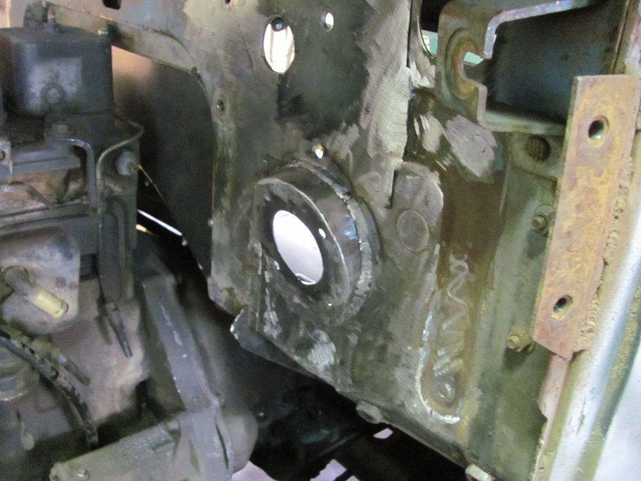

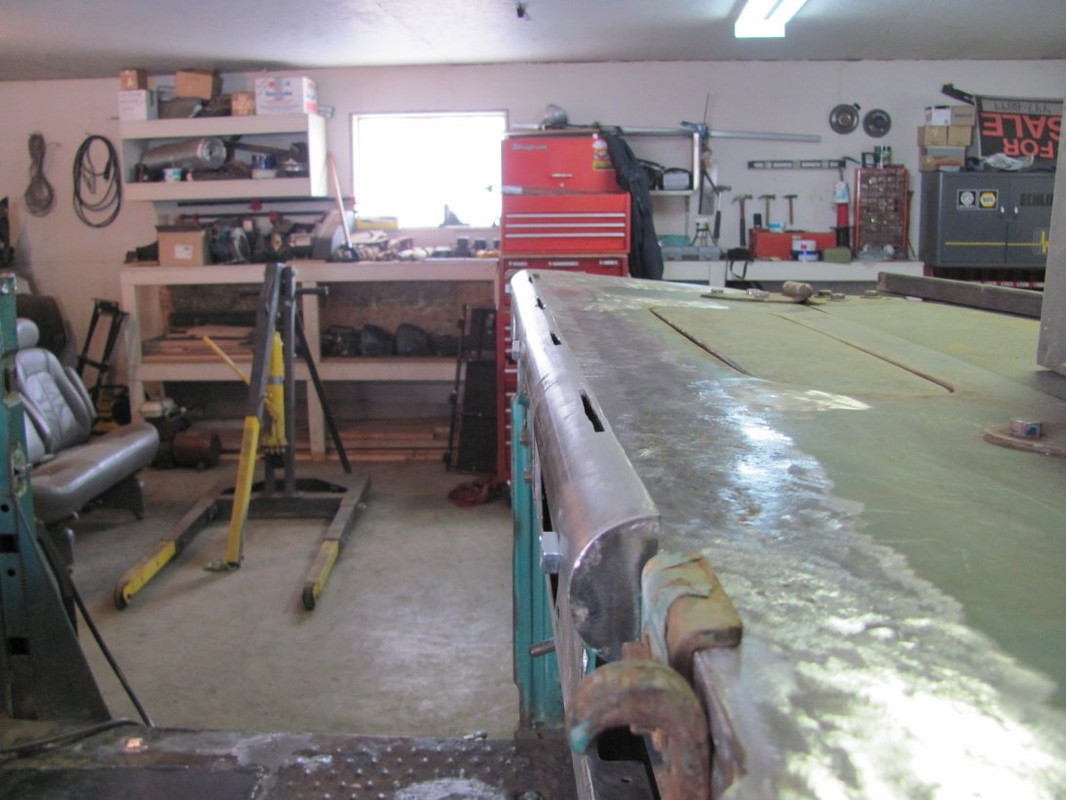

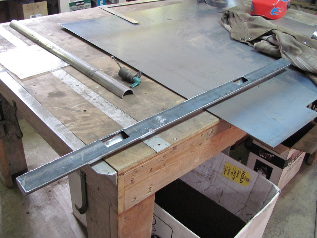

So I think I'm done the defrosters. Very time consuming! Made it so I can unbolt the defroster manifold if needed. there will be a rubber gasket in behind the defroster and the dash. The ducts are welded to the dash and I can hook up a 2" duct hose to them. I think I'll go with a Hurricane heater system with cable contols. Trying to keep things as mechanical as possible. (exept for the gages. of course) here are some pics. I do have room beside the glove box and the cold air scoop. If needed I will french out the glove box a little.

Master Yota
Posts: 828
Re: Building a retro M37
Post by Master Yota »
Nice work!
Thats one of the nicest defrost tubes I've seen yet. Kudo's! :mrgreen:

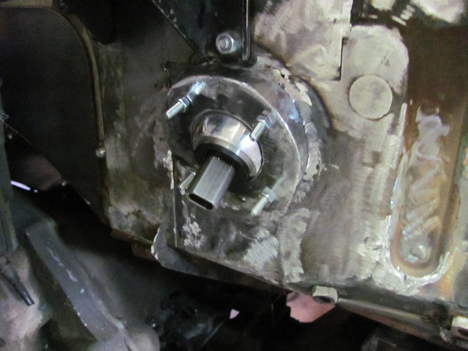

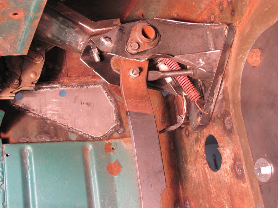

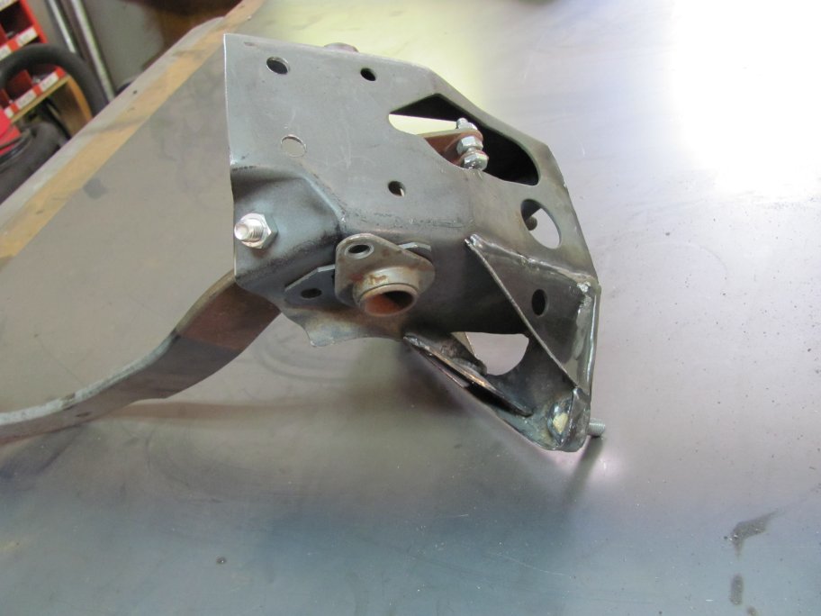

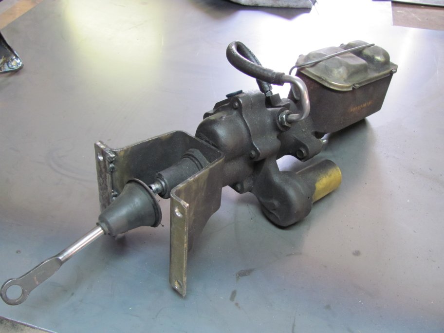

Well, I finished a couple of more items. I have now re-originzed the dash. I have made the gage cluster bigger and added a few more gages. A tach, boost meter, pyro and tranny temp. To the left I will have all the switches. They will be all lever style twist switches, just tlike the stock switches. No ign key switch just a lever switch with a push button starter swith. All others wiper, running lights, headlights etc etc.... will be the same style as the ign switch (twist lever) My personal touch I thought. I have also mounted the brake pedal. Everthing came out of a Frito Lay cube van. I kinda wanted hyra boost for the power brake because I have no vacuum pump on the truck. Because the hyraboost and the master cylinder was so long I had to move everthing off to the right and reconfigure the pedal setup under the dash do fit my feet. All in all it all worked out. I think I found a place for the battery, out of sight, inside the left frame just behind the tranny cross member. the spot looks good but could be tough to lift the battery in and out of there. Of couse there will be a remote boost station incase the battery goes dead. Oh ya, re configured the old convoy lights into my park/signal lights with amber bulbs. What i couldn't figure was why the square part ant he lower end of the light was blocked off, still with a bulb behind it. Makes the bulb useless. dunno.. just rambling......
here are some pics.
modified frito lay bracket.
my own bracket from dash to pedal bracket.
the power unit
completed dash
Parts installed. pedal is very comfortable as to position.
Next is the park brake and the throttle pedal.

And .... all the pedals are mocked up.

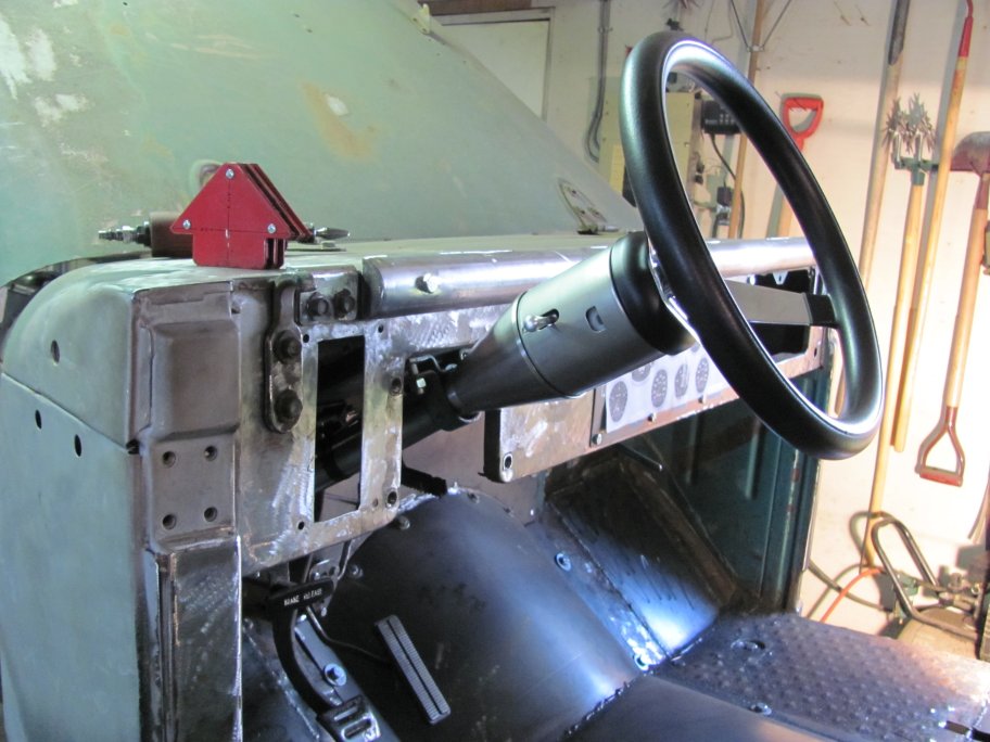

slow but sure.... the steering column is mocked up..
gotta put the seat in and double check distance.
next to mock up the heater
