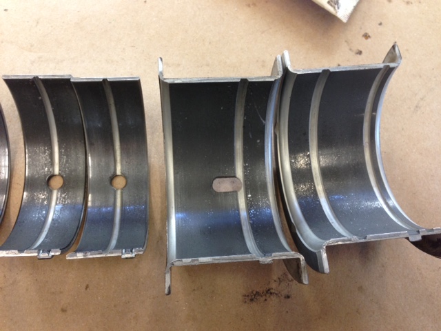

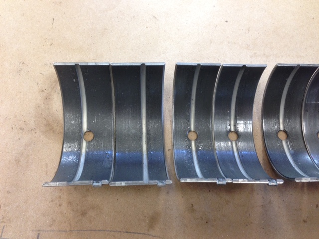

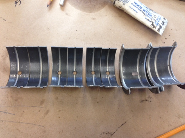

We finished up rolling in the bearings on Friday and found some interesting things along the way. The spare motor I have has larger (5/16") holes drilled in the crankshaft than the motor in the truck (~1/4"). I believe the motor/crank in the truck is older, but who knows! The oil passage in the upper 1/2 of the thrust bearing is also somewhat smaller in the new bearings. We also found that the motor in the truck has a much thicker flywheel than the spare motor.
Swapping the bearings brought the endplay back to spec and the oil pressure is greater, but there was no appreciable change in the vibration that's been bugging me. At this point I'm reasonably sure it's just poor internal balance. It has the vibe with the fan belt removed and the clutch/pressure plate removed. It's not likely to get sorted out until the motor is rebuilt.
