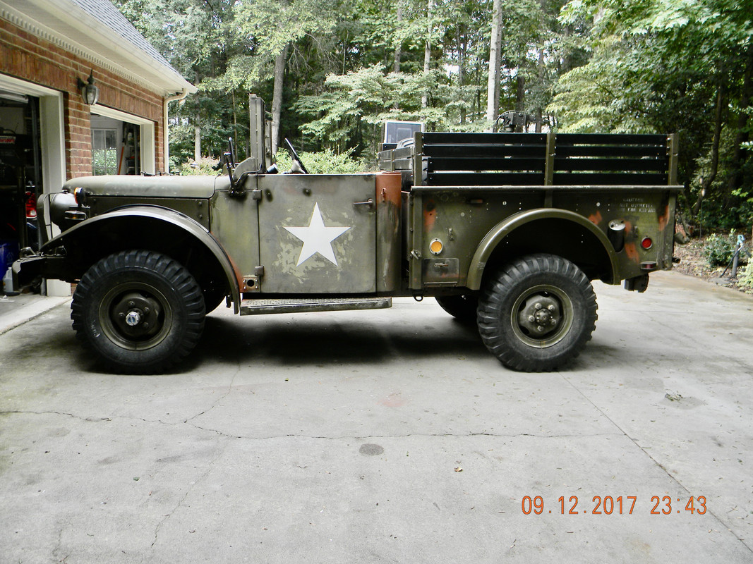

when I spent nearly a year, full time, "restoring" my '52 version, all I cold do was unbolt everything up front, engine/trans out of course. Then removed the bed, but I never could have been able to re-install all the electrics behind the dash. Much of my wiring was new, or is new now, with some help from Charles Talbert, who is about 100 miles north of me, had my truck up there for re-doing some of my own mechanics. My truck had been used daily for several decades, and parked under cover, so I was fortunate that I didn't have to deal with anything more than light surface rust, and my fasteners all unbolted without breaking off. If it had been more than that, I would never have bought it, with my limited space and equipment. Mine was basically unbolt, paint, reinstall. I admire those who tackle much more involved projects. Here, my truck after cutting the homemade top off, and before I started. Hal, UpState SC.
