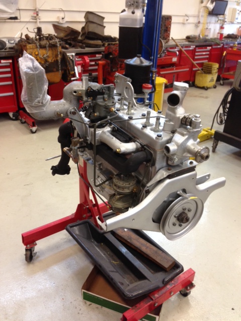

Progress! A bit on the late side, but progress none the less!
Jesse "NASCAR", Sebastian "Sea Bass", Russell, and Brian working away! Jesse and Brian worked ~ 8 hours today and did a great job, but I suspect they never want to see a flaring tool or tubing cutter again!
T245 & Kids.JPG (131.08 KiB) Viewed 1966 times
Notice we have actually added a CYLINDER HEAD! Yes, it's a CYLINDER HEAD!!! It's been elusive, but through perseverance, persistence, and generally being a pest we were able to grab it yesterday and put it on today. The CR is 7.9:1 so we're all pretty happy.
T245 Front.JPG (113.04 KiB) Viewed 1966 times
Con't: See next page for more photos of the lump.

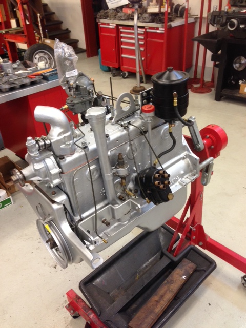

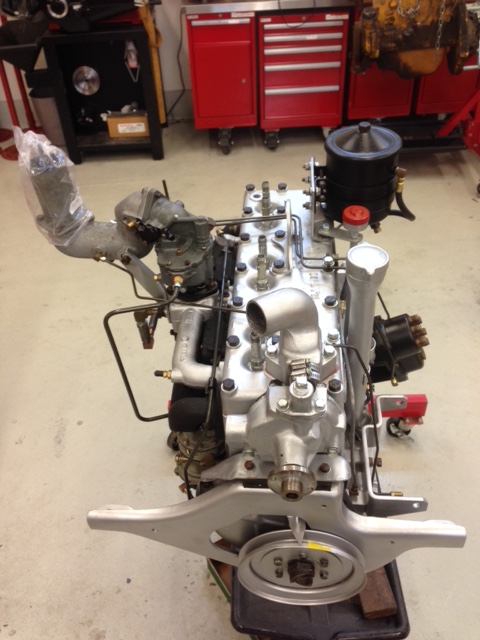

Re: It's Engine Re-building Season at SLHS
Hmmmmm... should have painted the oil pressure sending unit.
T245 Left.JPG (137.1 KiB) Viewed 1966 times
It may even run, of course it would have to go in the truck...<br /><br />Note: Must clean up shop over summer!!!
T245 Right.JPG (128.35 KiB) Viewed 1966 times
