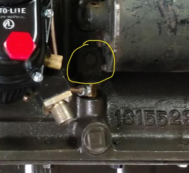

my plan all along was to hook up some sort of pre-lube system via the main gallery 1/8 NPT plug just aft of the oil pressure take-off site. I bought an assortment of 1/8 NPT straight and right angle fittings, but found if I put one in I could not insert the starter, and once the starter was in, there is about 1/8 inch clearance between the end of the starter and the port in the gallery, so there is not enough room to install and turn an inlet port. If the starter was about an inch shorter, it would work.
So my only option is to use the inlet port/tubing that goes to the OEM fuel pressure gage. I have mounted an Autometer mechanical oil pressure gage on the steering column, and in a day or so will have a "T" NPT adaptor coming from Jegs's, so I can add a line to the Autometer gage. I can also temporarily put in a NPT with a nipple and use my fluid transfer hand pump to force oil into the motor. But I discussed this plan with Charles T and he told me not to worry, as long as I used a good assembly lube everywhere (I used a more viscous one on the cam lobes, and a lighter Red Line assembly lube on the crankshaft, I use the latter a lot on my guns) as the pre-start oil will follow the path of least resistance, and just flow down into the pan, unless there is enough oil pressure to see a rise on the pressure gage.
I have to decide if I want to keep the OEM oil pressure gage in addition to the Autometer, or just plug an Accusump into its "T". I really liked the A'sump I had on my Cobra's motor, two quart, I would bump the pressure up to about 30 pounds before it bled off. I had an electric switch on the A'sump, with the canister in the engine compartment, but I would have to add a 24V to 12V circuit to use an electric one in my truck. So I considered using the fording cable to move a manual lever to open and close the valve, but the fording wire would have to work thru a 90 arc, and likely not be strong enough anyway. So back to putting the A'sump under the seats, with a manual valve where I can reach it.
I had AN 8 hoses for the A'sump in my Cobra, and pushing oil thru an 1/8 NPT would not work for racing G loads, but would be adequate for starting my truck.
found my throttle return spring catches on the carb's PVC connections, so my first chore in a few minutes is to move the hook-up hole a few inches higher, my plan is to drill a hole in a washer under a nut on a bolt holding the upper floor panel in, it is a straight line then for the spring and the little return wire.

Pull the spark plugs and crank it for a while. The assembly lubing you did when you put it together was a lot more than it normally would have so it is plenty good to go for some cranking time to fill the oil galleys.

JUST ME:, my starter must be tad longer than yours, because there is no room to get a wrench on a fitting there. Just engine variables, I suppose. I doubt a straight fitting would fit, for sure the 90 degree ones I bought won't turn. UPS just brought me the three port NPT for adding the Autometer oil pressure gage. Plus more Competition Cams break in oil. Now to run back to the local industrial hose and plumbing supply, need a different NPT/nipple for my fuel pressure gage, I have a liquid filled pressure gate screwed into it now. I am running temporary fuel lines just to get it gassed and running, from my rear mounted 24 V Facet pump, all new hard fuel lines, will later mount the regulator on the in inner fender well. Fabbed up a replacement fuel line shut off, got it I think from Grainger, needed only one adaptor nipple.
The drilled washer didn't have room, so cut a short piece of aluminum bar and it extends out an inch for hooking the short wire on the throttle return spring. Adding a small eye hook instead of just drilling a hole, reducing angular pressure on that thin wire loop.
Yes, my plan is to remove the spark plugs to crank it to get some oil where it needs to be. I cleaned and gapped my old military plugs, but since the washers were shot, got some Moroso plug indexing 14 mm plug washers. Set comes with about three slightly different thicknesses. I am on a first name basis with the Fastenal counter clerk, bought another bag of fine thread bolts there last pm, needed a few longer ones. The guys at the industrial plumbing shop are anxious to see my truck, I ordered them a Pizza for lunch not long ago. The chap at a nearby ACE a few minutes ago greeted me with a question of how much longer when I needed a single fine thread 1.5 inch grade 8 7/16 bolt.
