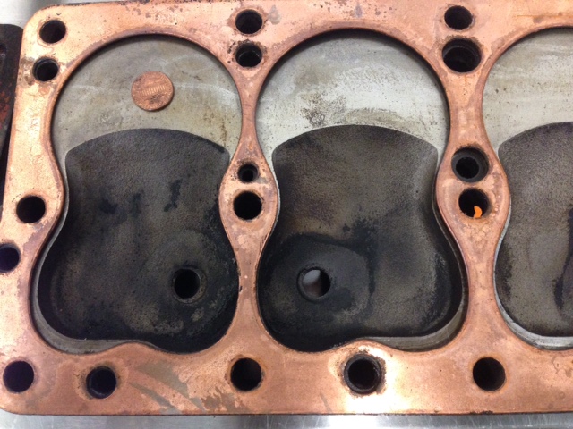

Here's Fel-pro's current gasket with the '51 Plymouth passenger car head. Notice the poor fit around the exhaust.
51 Plymouth 7 to 1, Univ. Gasket.jpg (143.89 KiB) Viewed 2609 times

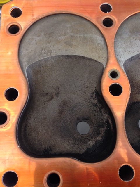

Here's the correct NOS Fel-pro gasket for the '51 Plymouth head. It's a 7:1 head, but when we're done we'll have 8:1.
51 Plymouth 7 to 1.JPG (121.4 KiB) Viewed 2609 times

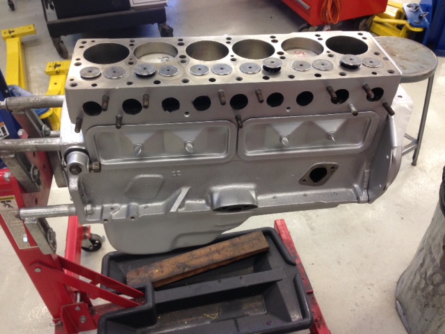

At least it resembles an engine at this point!

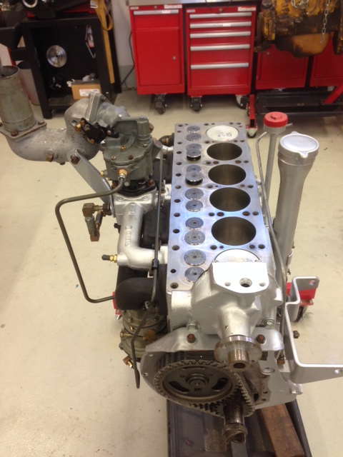

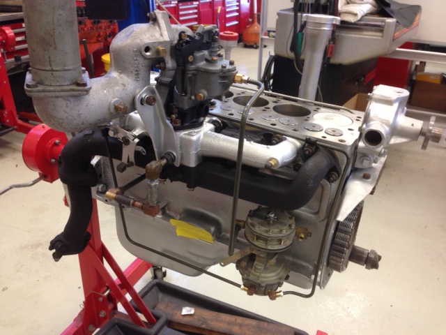

Engine Front.jpg (115.28 KiB) Viewed 2525 times
Engine Right.jpg (125.74 KiB) Viewed 2525 times
We've been waiting on the cylinder head for a 2 weeks... Maybe it will get buttoned up tomorrow, but running on the dyno by Thursday (last day of school) seems unlikely. I need to speak to my students and see how badly they want to finish it. If they're game we could have it running next weekend. If the head's done!!!!!!!!!!!! AHHHHHHH!!!!!!
