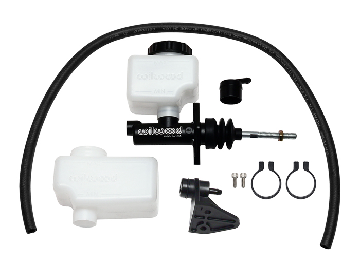

time to start thinking about brakes.....
hmmm the stock 1 1/4 single line master is $140ca for the cardon 1040544 and the RAYBESTOS MC785 is a whopping $290ca. but those options only give me a single line system.....
the dual chevy 1 5/16 option is interesting but it dose not have the same area to push on.....
1 5/16 diameter = 8.72883cm2 1.352in2
1 1/4 diameter = 7.9173cm2 1.227in2
2x 7/8 diameter = 7.75896cm2 1.202in2
my math shows that using two 7/8th masters will get me closer to the stock master.
I was thinking to use two remote res wilwood masters #260-10374($100ca) and a balance bar($80ca) for proportioning now I would need some inline residual pressure valves (of what weight ? 10psi ?) then figure out mounting and a connection to the stock pedal.
what are your thoughts ?

Re: 265 cdn m37
You have definitely thought this through. The 1/16 difference in master cylinder size will cause a bit higher pedal pressure but that could be offset if you can find a way to lengthen the long side of the pedal arm at the pivot point or shorten the short side. This will give more leverage from the pedal with the same force applied to the pedal. It will also bring the length of pedal movement back to stock. BUT, If you are going to all this trouble why don't you convert to disc brakes? Then a stock disc brake master works just fine.
Re: 265 cdn m37
discs would be nice but after shipping and exchange Im looking at well over $900 per axle without calipers . so thats out ......and I have like 5 sets of drums to burn through.
I had thought of changing the pedal ratio to get more push on the 1 5/16th chevy master but with the pedal being forged. I dont have the process down for welding such material.
