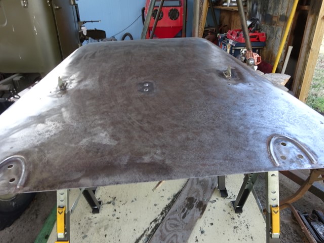

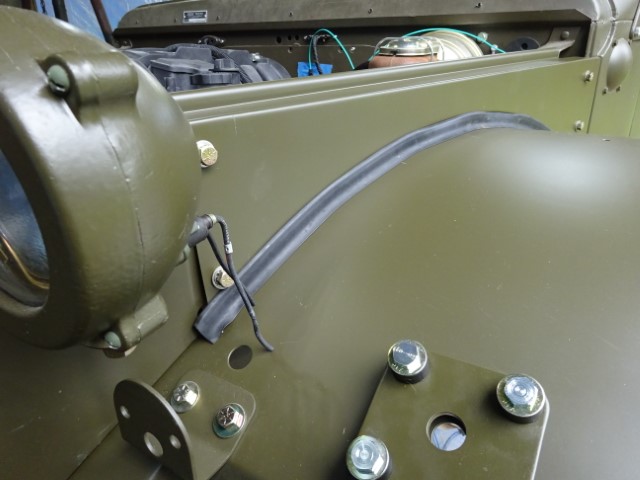

working on hood

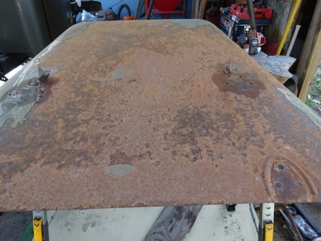

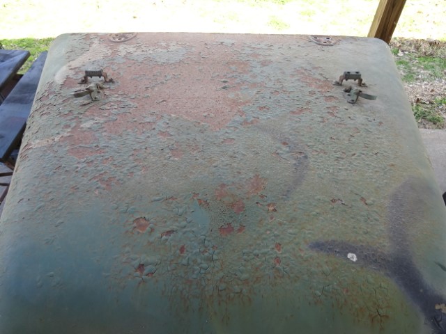

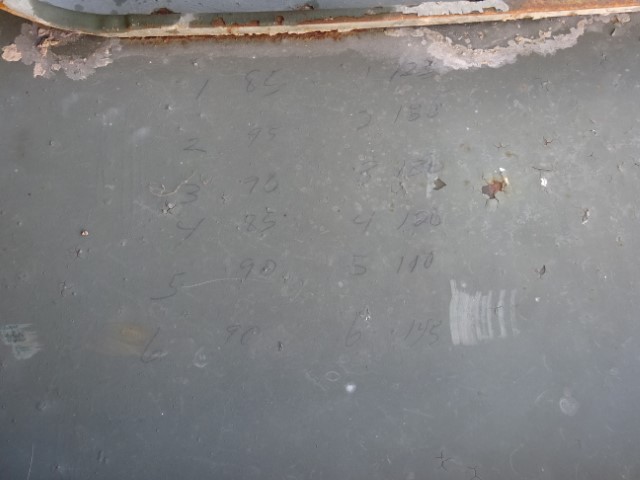

On the bottom of the hood I found this
Re: 1954 M37 rebuild thread
Compression numbers?
Hood is coming back, I wonder what caused the flaking/potato chipping, improper prep maybe?

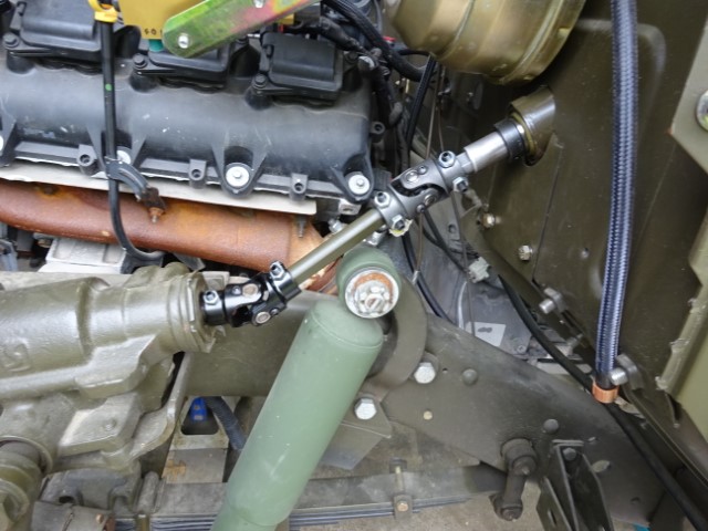

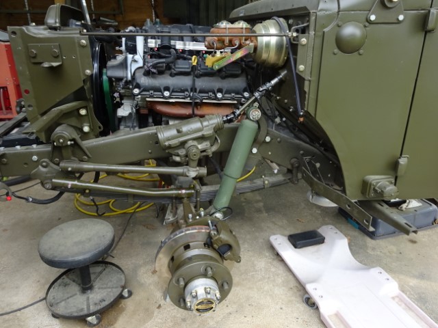

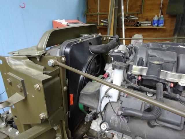

Got my steering column finished
got the electric fan installed
DSC01491 (Small).JPG (119.66 KiB) Viewed 2982 times
DSC01489 (Small).JPG (122.32 KiB) Viewed 2982 times

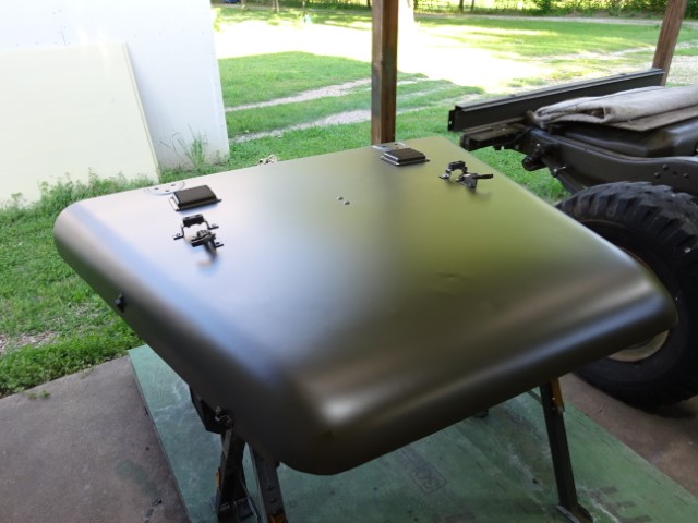

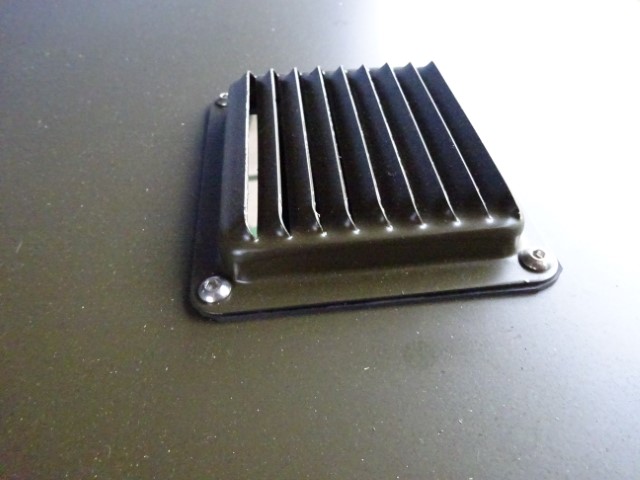

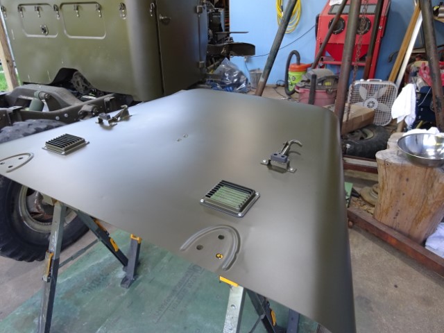

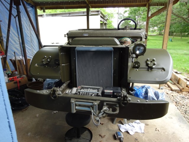

Hood done! Even got my thermal diffusers installed.

Looks good. Are the thermal diffusers ties to anything specific or do they just dissipate engine heat from under the hood?
NCM wrote:Looks good. Are the thermal diffusers ties to anything specific or do they just dissipate engine heat from under the hood?
With the hemi under the hood, heat removal is the objective.

They will probably help some with the heat after shutdown, but I imagine with the mechanical fan and the open underside to the engine bay there should be plenty of airflow while the engine is running. Did you make those vents or are they from another application? Either way, they look good.

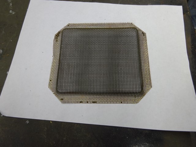

The vents came off of some kind of military vehicle, had screens under them- bought them on ebay.

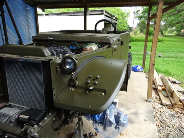

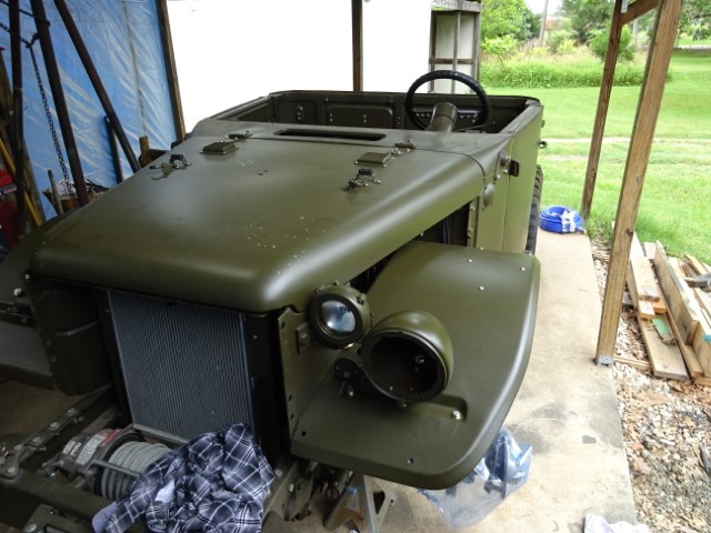

Starting to look like a truck again!

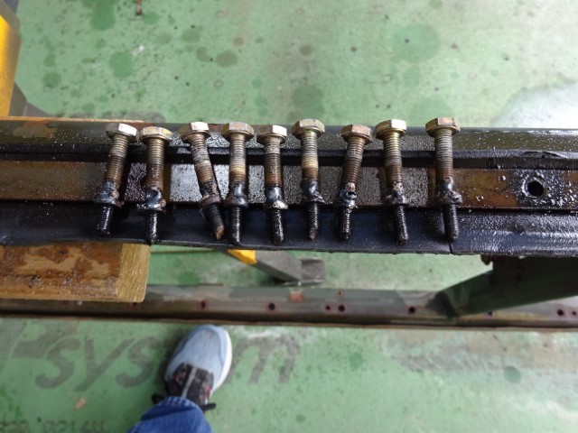

Here is how I managed to extract the bottom seal screws- lots of kroil and patience--all came out.
