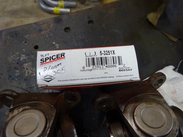

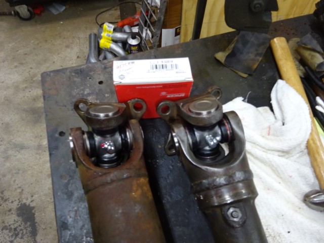

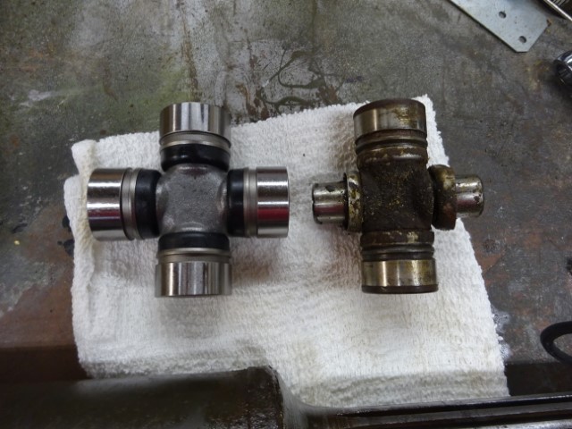

Front driveshaft u-joints replaced. I used Spicer 5-3251X u joints (US made). You can see the size difference between it and the Detroit that was in it.

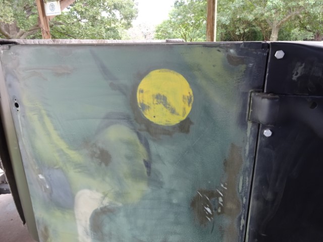

Anyone have this yellow dot on their truck door? found it while sanding for paint, I sanded slowly- but saw no markings on the disc. Passenger door.

Bridge Plate/Marker, the "4" must have been sanded off?

Yeah looks like it to me, Bruce!

You can get the decal with the four on it along with any other stencil or decal you want from the chap who advertises here, I momentarily forget his name. I used his stencils when I painted my truck, but the bridge class yellow four is a decal. His prices are much better than Ebay. By the way, when we put the stencils on, they have a sort of adhesive on them, my son sprayed a very light mist of rustoleum white many times, just a mist and it looks great, no runs, perfect edges. We did mask off a lot to protect from the mist. HC

Rick Larsen http://www.milstencil.com great person easy to deal with too.

m-37Bruce wrote:Bridge Plate/Marker, the "4" must have been sanded off?
I thought those were only on the front grill?

the four inch yellow 4 is on the doors, Rick has a decal for this, on the grill you can put a metal plate holder, with clip in numbers, for a bridge classification for the the truck and any trailer it may be pulling. I believe the first number is the truck, the second for the trailer. You can get the plates/numbers from different sources, mine are subdued from a bigger truck, so I clicked in the numbers for a M37.. I am pretty sure a M37 gets a four rating for the first number, and I have a zero for the second, as I don't have a trailer. Rick has stencils/dedals and dash plates for just about anything you could imagine. NV

The Bridge Plate kit comes with all the numerals any historic mil-veh might need, I got my set from Rick 20 years ago at the MVPA national convention at Ft. Lee, VA.

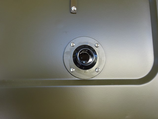

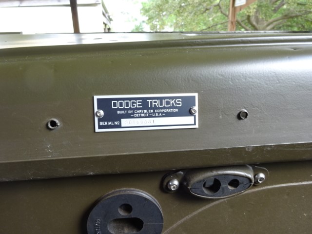

DSC01314 (Small).JPG (114.21 KiB) Viewed 2569 times
DSC01315 (Small).JPG (113.31 KiB) Viewed 2569 times
DSC01317 (Small).JPG (90.27 KiB) Viewed 2569 times
small stuff done.

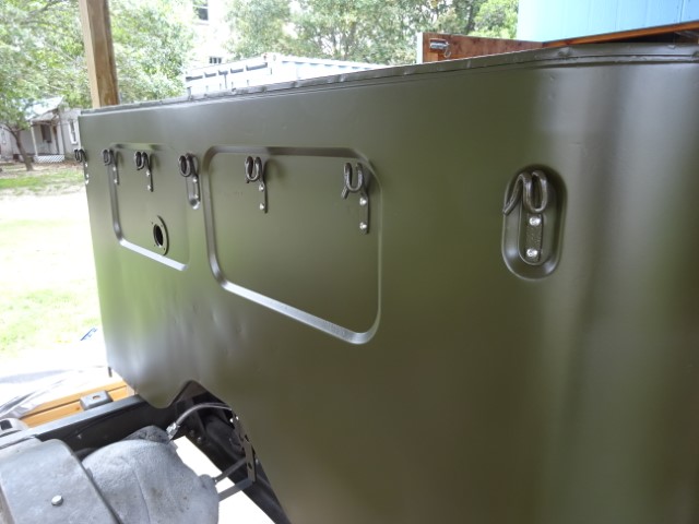

Re: 1954 M37 rebuild thread
DSC01318 (Small).JPG (94.69 KiB) Viewed 2556 times
DSC01326 (Small).JPG (73.01 KiB) Viewed 2556 times
more little things,

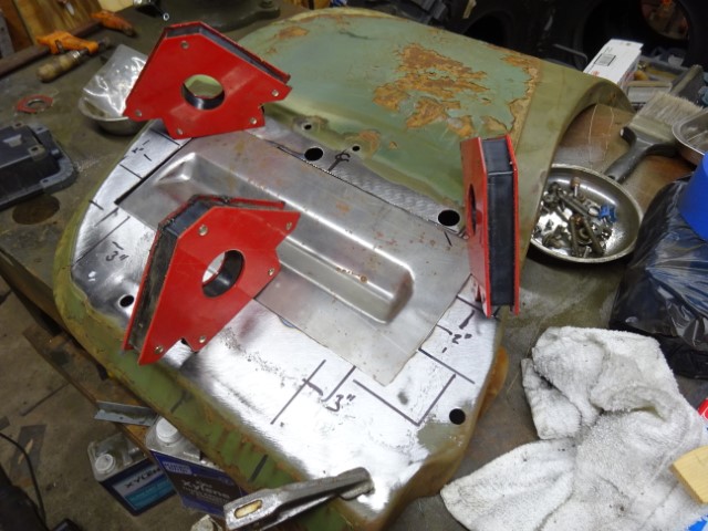

DSC01330 (Small).JPG (114.6 KiB) Viewed 2541 times
DSC01337 (Small).JPG (125.27 KiB) Viewed 2541 times

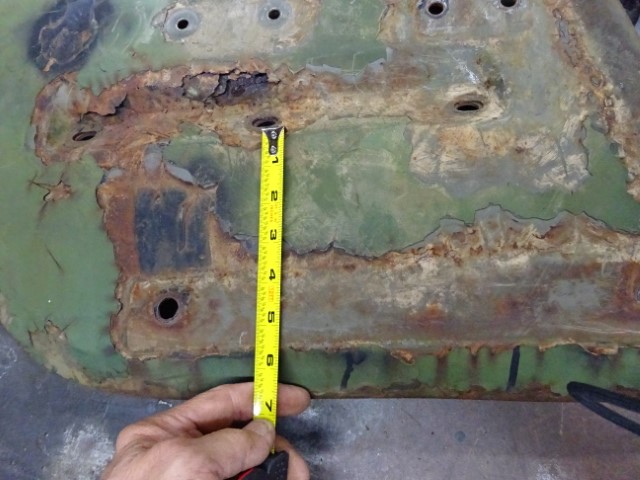

The job I have been dreading has started.
You'll have it "like new" again in no time! Thanks for the picture!
Post by sturmtyger380 »
When you add this new piece of metal how are you going to deal with the reinforcing piece on the underside?
