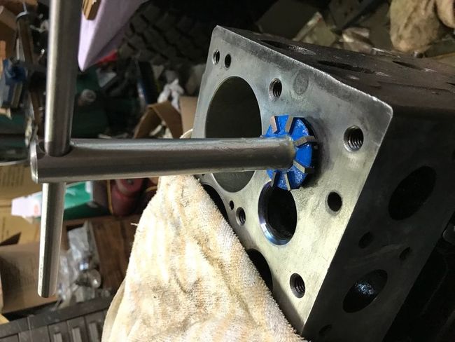

Engine parts all laid out.
NOS connecting rods from John Bizal.
Using the valve seat cutter.
I forgot to take photos of the seat grinding process. But here is the finished seat and the valve lapped in.
