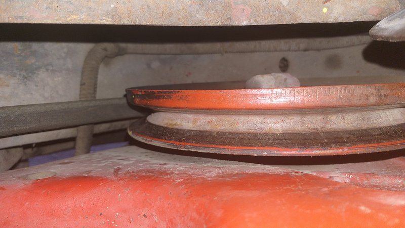

Hello my friends!!
I will be posting "my" way of solving this issue without disassembling de radiator to restore the pointer back
here you can see the ruller. without any pointer:

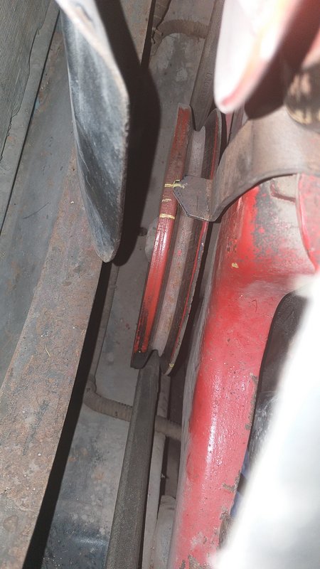

here the pointer bolted from above in a way that it can't move.
then I aligned the so marked "0" in the pulley with the pointer.

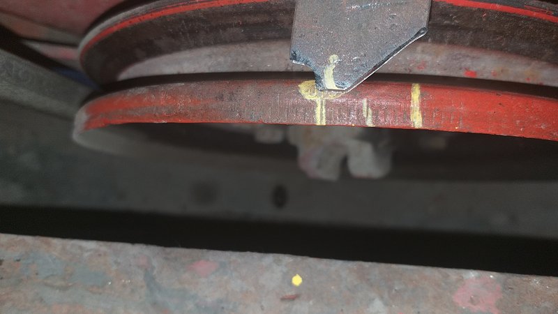

in this picture the left mark in the pulley is the "0" (you will see a 0 marked originally), the middle yellow mark is 5° and then 10° on the right, you have to align it from above. your eyes must be near the radiator cap to align it.
In this picture it is showing like 1°due to parallelism error
now the engine iddles very good and works fine at high RPMs it does not missfire as it did before but still not so much power
hope this helps for others.

We let it at 4° before TDC is that correct?
I have read it has to be after TDC?
and at what RPM should I adjust it?

Re: Need help finding TDC
Sorry Vit,
I recall Charles posting that 2 degrees AFTER TDC was optimal. I always adjust timing at idle speed.

Charles posted on the Dodge M37/M43 Facebook group a few weeks ago that 4˚ before TDC was optimum. I've read that somewhere else as well. (Someone also told me that there is a typo in one of the manuals where it says 4˚ AFTER, but I have not checked for myself.) Link to the thread (Charles' comment is buried in the replies)
