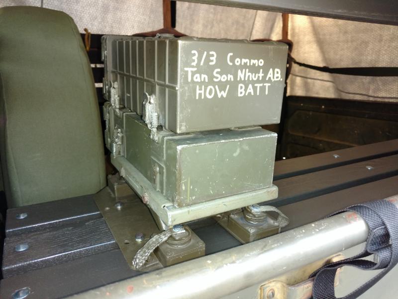

You might enjoy this. The new radio I just got for my truck. The service card inside indicates it was there beginning in late 68.
