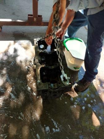

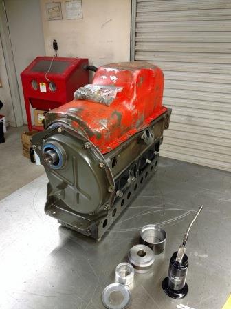

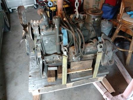

As Delivered
As Delivered

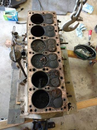

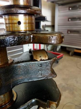

What was inside
What was inside

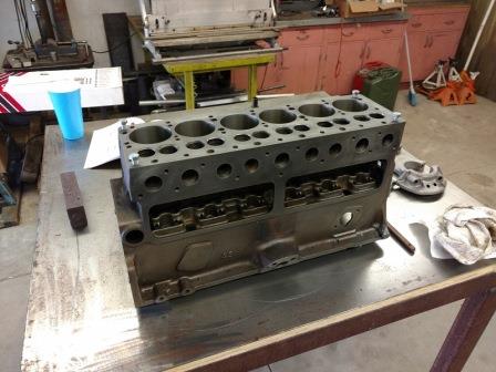

Cleaned
Cleaned

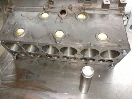

Banging in plugs
Banging in plugs

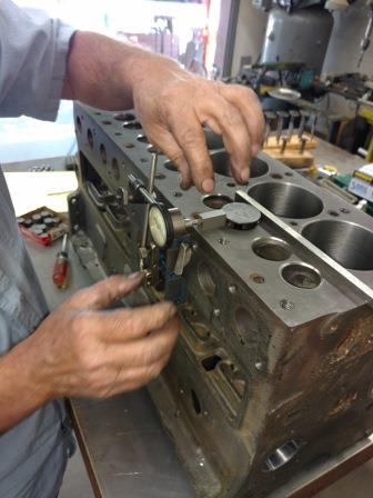

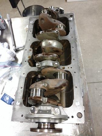

Clearance check
Clearance check

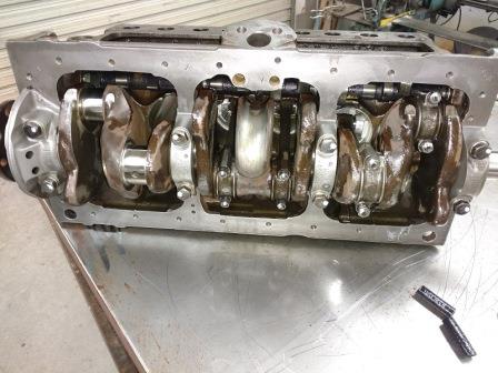

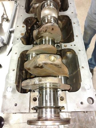

Crankshaft
Crankshaft

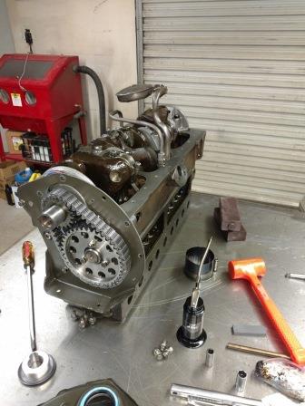

Front case
Front case
