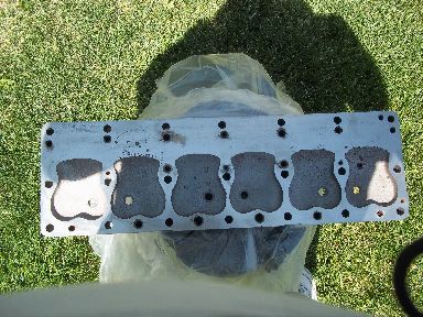

Hi guys,
After they blast it then magna-flux it, they'll shave just enough off to ensure it's perfectly flat. I'll post photos once I have it back.
Re: So now, to the blown head gasket...
So I got the head back today-they took off .005 and the surface is perfectly flat. Now I need to address the block and the freeze plugs.
More to follow,
More to follow,
- Head resurfaced .005.JPG (40.54 KiB) Viewed 2201 times
- Posts: 1818
Cool........another picture
Looks like you are going to be back on the road in no time Gary. Is the top of the block pitted at all around the leaking area?
