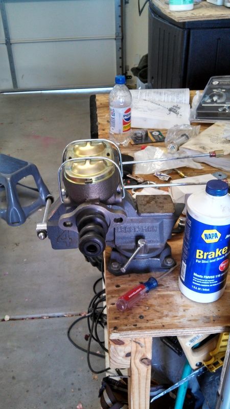

This is the M/C from Speedway Motors I used. It was a "bit" wide they do sell a truck style one that looks less wide.

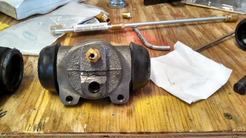

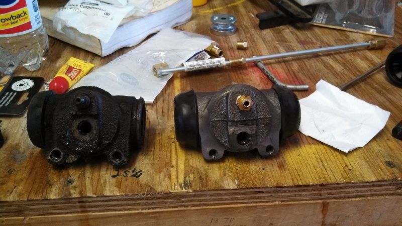

first comparison. as stated before, the banjo port is low. Also, as you can probably see, I "machined" some casting ears back. This might work on an actual B4 power wagon, but not on the M37. Its guts didn't go to waste though.
Close up of said "machining"

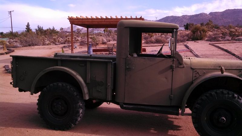

And a poorly angled shot of him after another test drive, to check brake function and how awesome the Interco TSl's are ride wise.
Also, desert winds make for sandstorms under said truck while working on it outside of a garage.
Re-installing the tranny cover would be a good idea as well...
