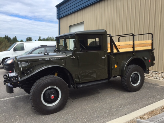

Truck is pretty much done, except for some window seals, winch cable odd thing here and there.
Ended up chopping 2'' from the cab roof and windscreen, deleted the plates on the back of the front fenders and added some civilian badging.
Line-x inner fenders, step ups, inside cab and box.
If there is interest, I can post a few more pictures of the finished truck.
Drove it to work for the first time this week which felt great!

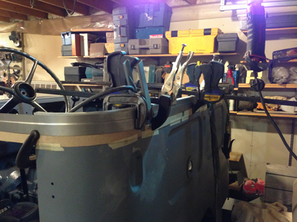

This is all I could find regarding pics of the roof chop, must have been going through a work mode and forgot the camera.
Basically I rebuilt the pillars out of 1/8 plate and welded in pipe similar to original design (however shorter as I felt the originals were too long and tapered so fit was easier).
Salvaged the lower channel from the original roof and wrapped a stepped sheet metal strip to it (shown on pic) and the rear window opening, the rest of the roof I sent out to have new sheet metal added as I just needed to get the project moving again.
The new sheet metal wrapped around the pillars, attached to the channel at bottom and to the original roof at top, the rear window was then sectioned in.
While that was happening I took out the 2'' out of the windshield which was tough to keep straight and also to keep the channels open to allow for the weather seal and the glass, but making sure that structurally it was still okay.
I took out the 2'' below the swing out arms so the geometry was not affected, new glass cut and went together pretty good.
I had multiple door glass frames so what I did was put two together into one, placing one 2'' up from the original, this way the lower glass stop worked off the original frame and the upper stop was attached to the section that was set 2'' higher.
So when the window is rolled up or down it looks original but the glass is 2'' shorter.

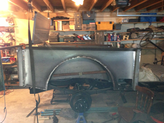

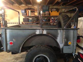

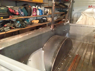

Thought I'd post some pics of the box side rebuild, took the best stake posts that I had and welded onto 1/8 plate that I had bent.
Rebuilt the wheel wells and cut holes in for tool boxes and filler neck etc.

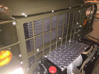

Here's a pic of the custom grill shroud hiding the sheet metal ends.

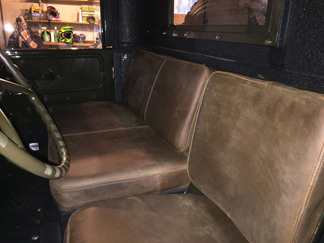

Picture of seats below, I went to Tandy Leather and picked out a couple sides of a cow (likely not the same cow
It's like an oil skin, almost like a baseball mit, has branding marks and fence scratches which is pretty cool.
Took to a local upholstery guy who did a great job putting it together.

I am liking the seats allot. What did you use for the backing? Foam?
Re: Custom or Not?
Seat backs are original springs cleaned up and painted with a dense +/- 1'' mat, I think this mat is also used under horse saddles?
Bottoms, 3'' foam on passenger side and 4'' foam on drivers.

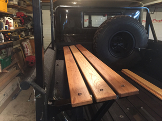

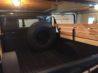

Pictures of the box finished and the troop seats.
Box is Line-X'ed except for gas tank and filler neck access.
wood is ash with clear coat.

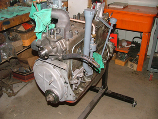

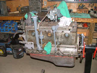

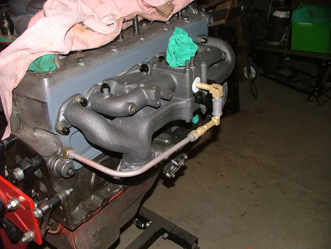

Some pics of the 251 going together, most of internal the motor work was done by a previous owner.
Block came to me oiled down and wrapped in plastic, new cups, valves, seats, rings and cylinders honed from what we could tell.
My late father in law (who knows these motors well) checked it over for clearances etc.
From there it was really just a matter of paint and bolting up accessories which was fairly straight forward as I had the original motor to reference to.
