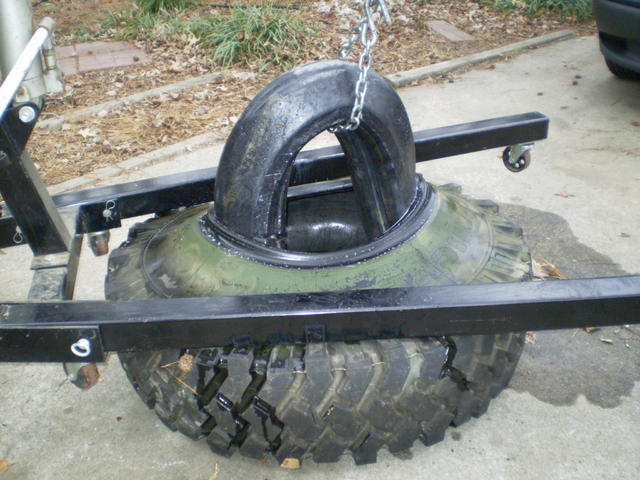

No need to use a sawzall to remove the run-flat. After the LAV rim is removed, simply reach in and work a chain around the runflat insert & hook it to an engine hoist. Place engine hoist front legs on top of the tire sidewall, and connect chain to hoist hook. As you gently pump up the hoist ram, spray a mixture of dishsoap & hot water around the tire bead & the runflat, and the runflat will slowly 'birth' it's way out of the tire.

Hi Tanner,
I have heard of that method, but having seen and dealt with the runflats, I thought "No way that would work" But hey, seeing is believing. Thanks for the picture, like I said, I didnt believe it would work.
Tim
Tim
Re: NEW Military GKN 1 piece tubeless M37, M101 & M101A whee
Yeah, Tim...it works. Takes a lot of lube, though, and the labor pains are fierce. As stated in another post, that there K-Y Jelly will reduce the friction and ease withdrawal.
