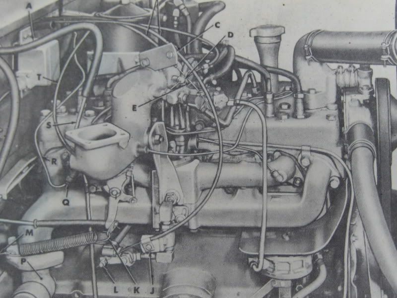

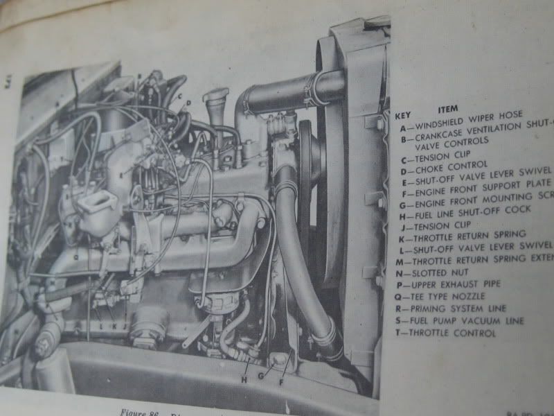

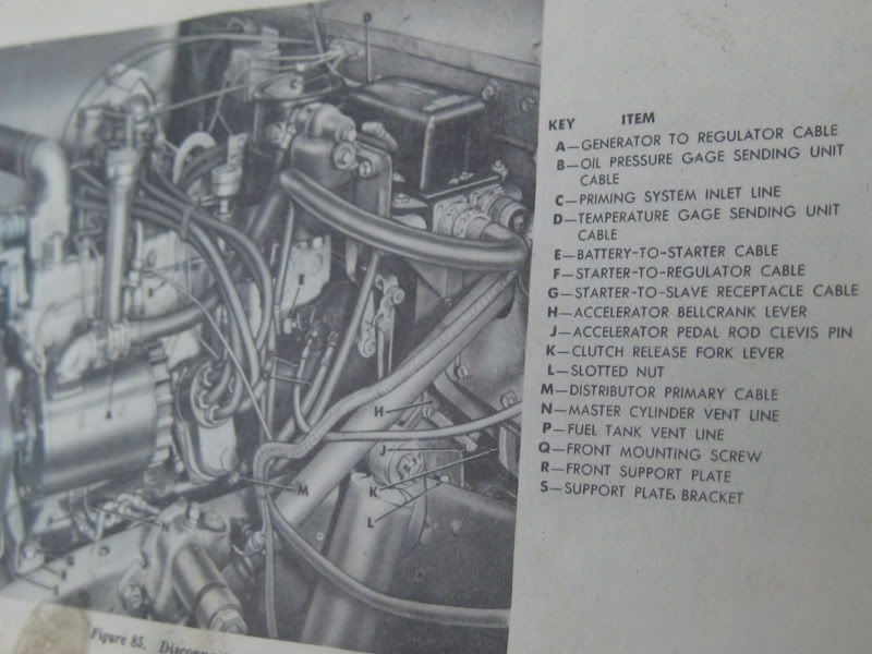

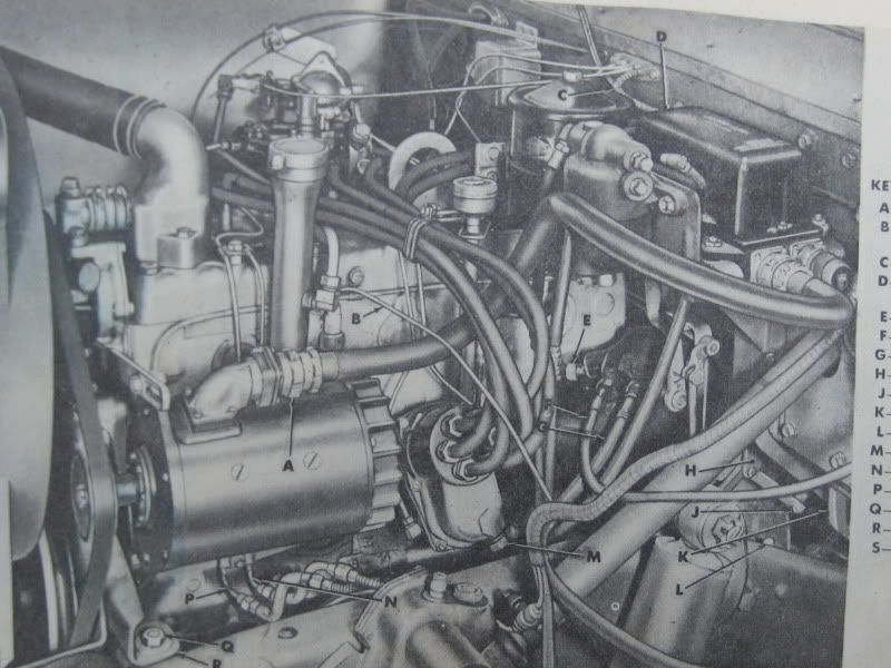

Copied these from TM 9-8030. A lot of early features are shown, but you can get some idea of where vent lines ran. You can see where the lines bend toward the back of the engine to get around the lifting eye and then extend to the air cleaner elbow.
Great pictures, Carter. I have been trying to work my way through the manuels, but sometimes it gets a bit frustrating when they are all saved on the computer and you have to scroll constantly.
