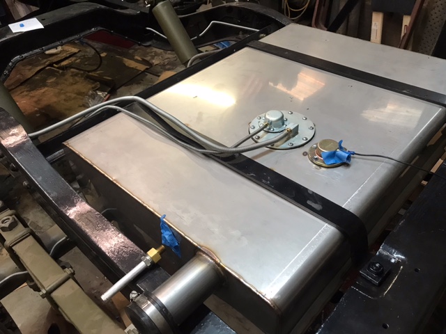

It’s been a long road since my last post. Years ago, I had picked up a nice M37 fuel tank that had been used by the Army slung under a generator trailer. I cleaned that tank and it had pin holes in the low hump part of the tank. Why they didn’t put some sort of drain there I don’t know. Where the drain is, is not the low part of the tank.
I bought the KBS fuel tank sealing kit and used that. The tank is sealed but I just don’t want to be at a show someplace and have the bugger start leaking again. I sprang for the VPW stainless tank.
The VPW tank is not just a plug and play item.
I had to re-bend my lower tank straps to fit the contour of the VPW tank. This meant the stock bolts were about 5 -6 inches from the frame mounting holes. I had to buy much longer mounting bolts.
It was a pain the rear to try and force the lower strap up to get the bolt to bite on the upper strap weld nuts. So, I gave up and cut the bolts and welded them together to make something that looks like a threaded rod with a shoulder in the middle. Then I put the straps on and measured the gap between the lower strap and the frame. I cut pieces of small pipe and slipped them over the threaded rod bolts and then welded those on the bolts.
With a spacer made from a small pipe I was able to tighten the lower straps up to hold the fuel tank securely in place.
Fuel Tank

Looks great. How many gallons in the tank?

What Bob said, very clean install! Like the way you did the extension.

Don’t feel bad, installing a stock tank with new straps is a dog gone bugger.

06boblee wrote:Looks great. How many gallons in the tank?
That's a good question. I looked on the VPW site and don't see a mention of the size. The stock one is 25 gallons.
But I am thinking that this tank is a little more square than the stock one. It might hold a little more.
