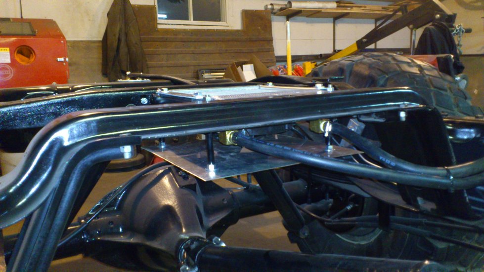

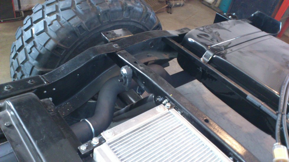

As long as the rear pinion seal is good, and the U-Joint not over greased, the oil cooler should be good there. Otherwise it might get oiled and filled with crud.

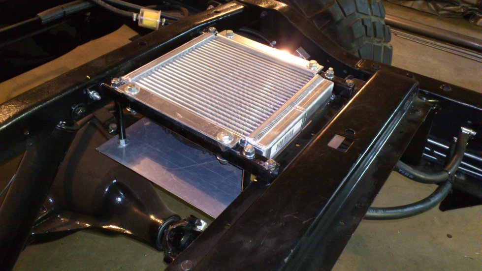

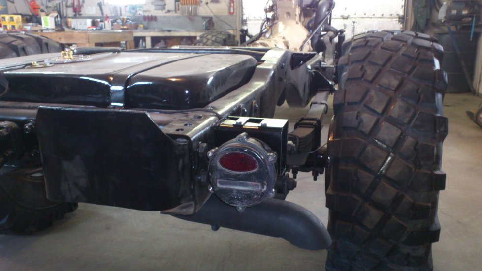

well I mounted the tranny cooler. I also mounted a shield under it to protect it from debrie and oil as W_A_Watson_11 mentioned. Thanks for the tid bit.

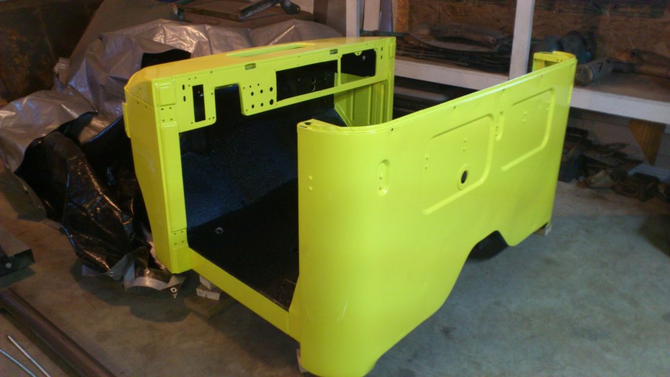

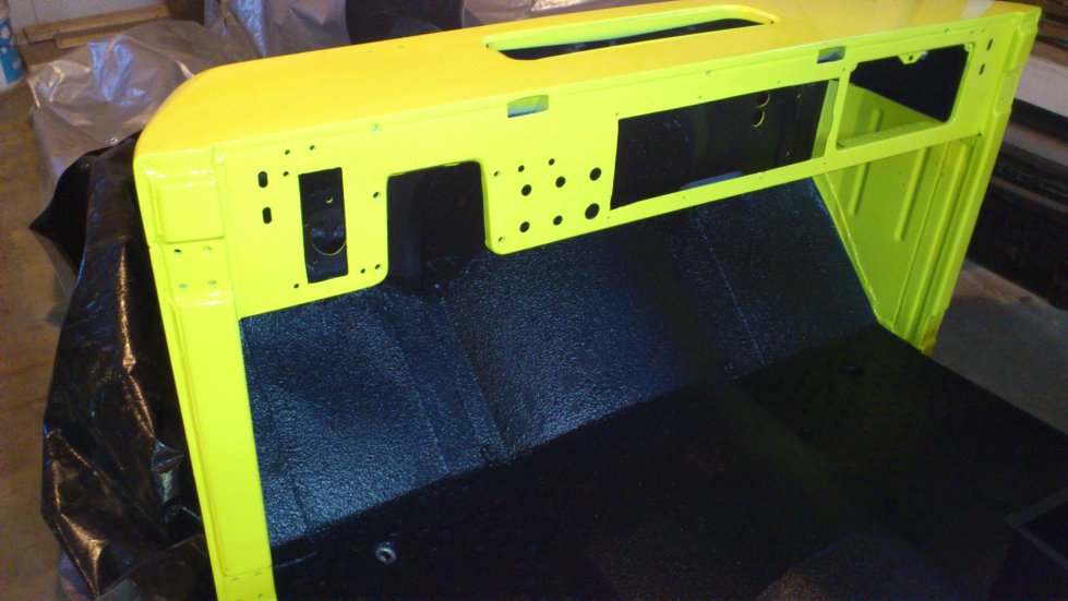

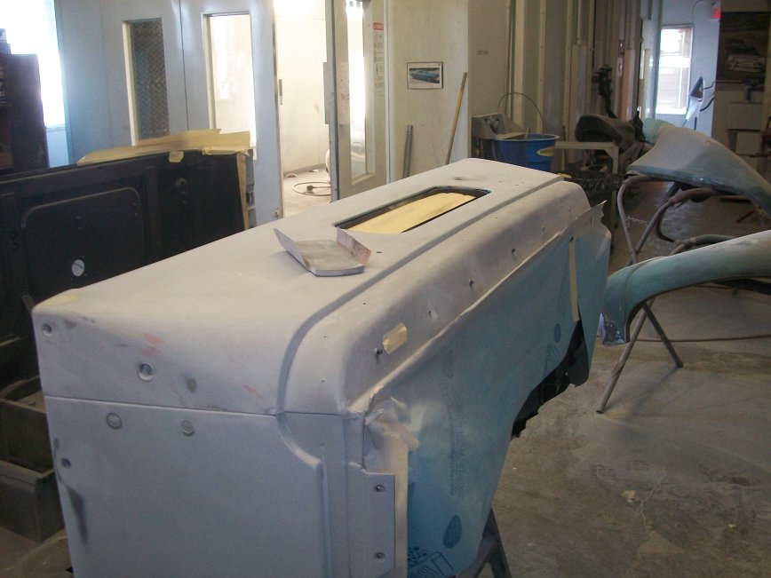

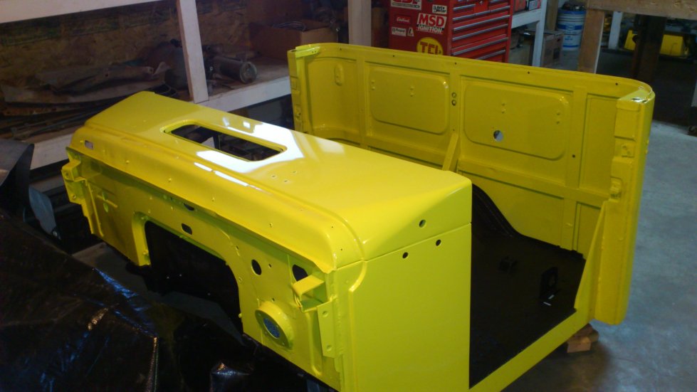

and here are the cab pics I promised,
You can see the box liner covered the floor very well.
I am starting to like the color. I think the contrast with Black will go very well. I think the boys at Khaos Kustoms did a very nice job!

HMMM... FOR SOME MYSTERIOUS REASON, I THOUGHT YOU HAD DECIDED TO GO WITH "CUMMINS BEIGE" ON THE EXTERIOR???. ANYWAY, THIS YELLOW-BLACK CONTRAST LOOKS NICE!!! IS THIS LIKE A "CATERPILLAR YELLOW," OR IS IT THE PICTURE THAT MAKES IT LOOK LIKE SO?
Posts: 1820
Re: Building a retro M37
I was jealous at first when I thought you had a spray booth in your garage then I read the rest of the post.
That color really stands out, I can't wait to see the finished truck.

The yellow looks good. How much air flow do you think the oil cooler will get in that location? I like that idea but I'm not sure it will get a good amount of airflow to make it useable. I'm not knocking what you did your work is great, I'm just wondering that's all.
Posts: 1820
I can see a fan under it in picture # 2 of the oil cooler.
retiredguy
Posts: 187
Joined: Tue Aug 17, 2010 7:46 am
Location: Stony Plain, Alberta, Canada
Post by retiredguy »
The oil cooler does have a fan. There is a better picture of it on Page 9. This is not a cheap unit so I sure hope it works. Everyone I talked to and everything I have read about it says it should be ample. If i drive at 70 mph in overdrive, I may get much more heating of the oil. It is not a lockup tranny. I calculated 70 mph in OD engine will turn at 1500 RPM. If it heats to much I'll just have to run in direct.(3rd) . I guess time will tell. So far I've been building the exhaust and I am almost done that. Then to put in the 4wd shift cable some wiring and then drop the cab on and start wiring up the dash. Still missing 4 gages though.......

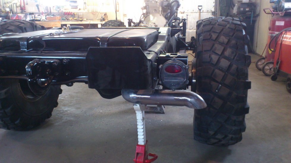

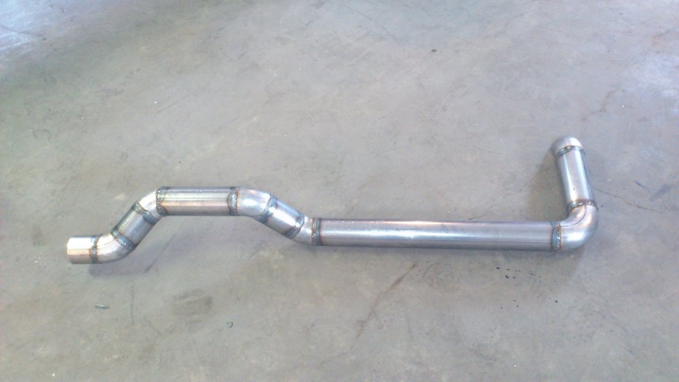

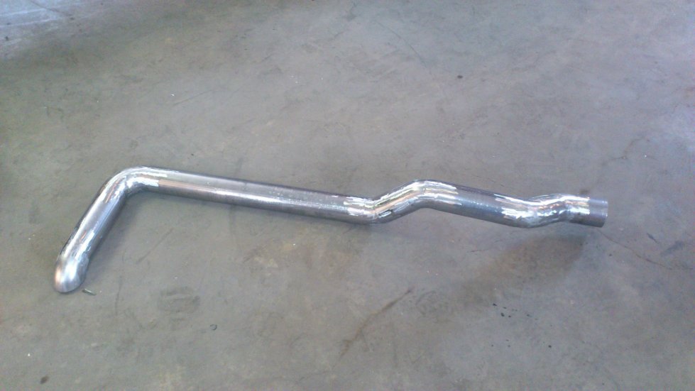

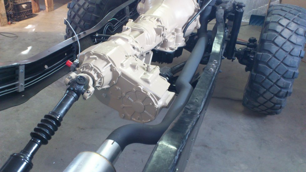

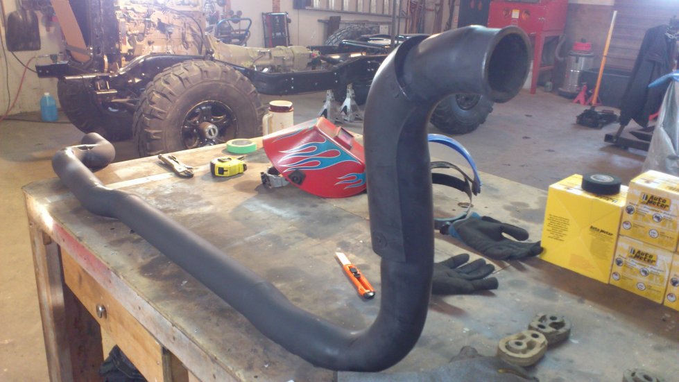

The exhaust is done
the front pipe is half the old one and half my custom piece.
Tail pipe is totally my creation.
ground the welds off a bit
Now the exhaust is done I'll install the transfer case shift cable and lift on the cab! It's starting to look like something.
Posts: 1820
That exhaust system looks very nice.
