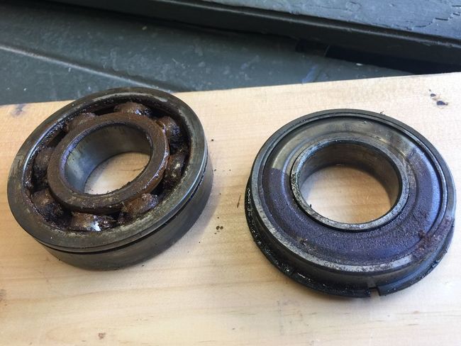

After I showed pictures of the inside gears of the NP420 I had gotten I took the rear output flange out, and I could see the seal was in not too good shape. I took the housing off the rear main shaft and I could see the bearing was in bad shape.
So, I pulled the input shaft off and those bearings were not too good as well. So, I began a search for bearings.
The not too happy bearings:

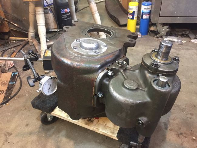

With the new NP420 bearings in hand and a counter shaft I installed that, the reverse idlers and placed the gasket on for the PTO.
The manual calls for using six 0.005 gaskets for the PTO to start with to set the preload. Since there were two 0.030 gaskets in the kit, I chose to use one of those to start with. I bolted the PTO on and used my dial indicator to check the play in the counter shaft. The specs call for 0.003 to 0.008.
My play was right at 0.003 movement. Since this was at the bottom end of the range, I added a 0.005 gasket and the play came up to 0.005. I left it at that and left the PTO installed.
