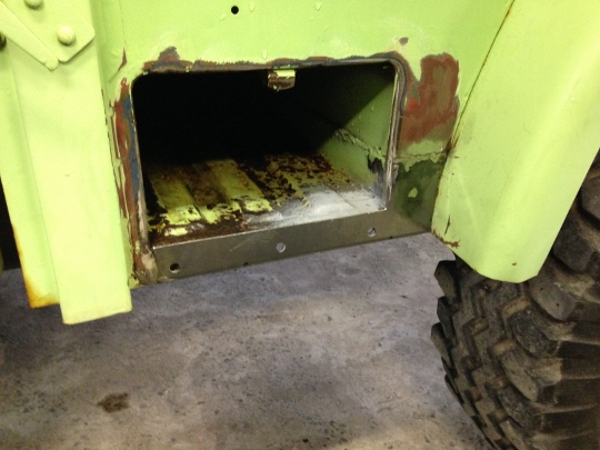

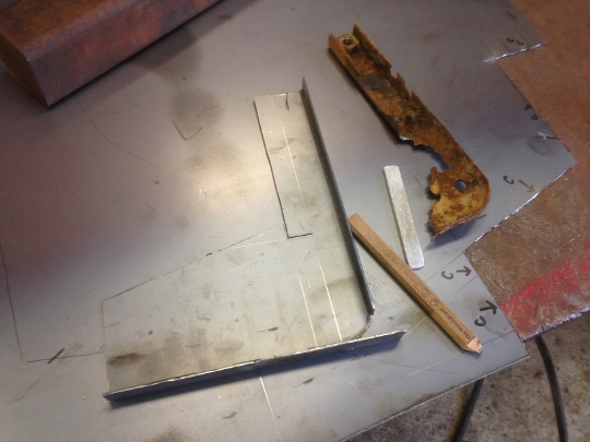

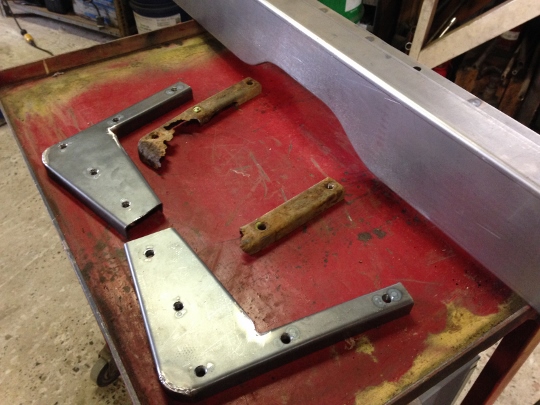

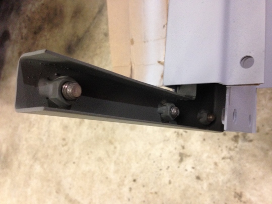

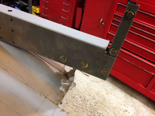

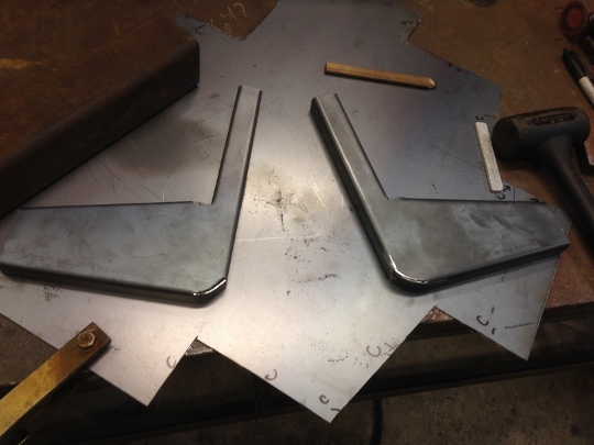

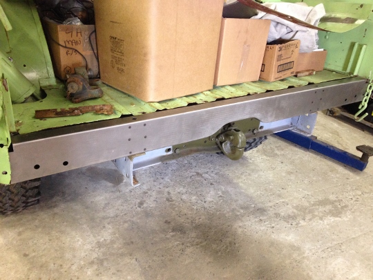

Finally back to work some. I ordered the rear bed cross member from Midwest. I planned on repairing the old one. After I cut open the outside I found the whole inside a mess. I could have made a new one but I would have had to make in at least 4 or 5 different pieces. The cost vs labor wasn't worth it. The rear cross member looks great. In the picture its just sitting in place. The brackets that go in the end of the cross member and up into the bed sides were all but gone. In the pics you can see all that's left of them. I couldn't find a picture anywhere so I just sort of made them to suit me. Also the passenger side bed side bottom where the piece fits into was gone about 5" up so had to make new one as well. Got it all together now and have ordered some 5/16 truss machine screws for the floor to cross member bolts.
IMG_1239 (540x405).jpg (161.25 KiB) Viewed 4217 times
IMG_1242 (540x405).jpg (121.85 KiB) Viewed 4217 times
IMG_1244 (540x405).jpg (115.11 KiB) Viewed 4217 times

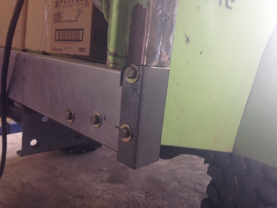

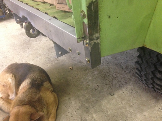

few more of end brackets
IMG_1246 (540x405).jpg (153.79 KiB) Viewed 4216 times
IMG_1247 (540x405).jpg (144.84 KiB) Viewed 4216 times
IMG_1248 (540x405).jpg (110.16 KiB) Viewed 4216 times

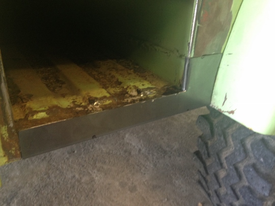

Repaired the bottom of the bed corner
IMG_1250 (540x405).jpg (102.21 KiB) Viewed 4215 times
IMG_1252 (540x405).jpg (141.8 KiB) Viewed 4215 times

The brackets you made look great and substantial. I have some pic of the originals, I'm guessing they are cast? Good work and progress, I gotta get back out there!

The pieces that were left of mine looked like stamped steel. Like made in a die and press. Maybe some were cast not sure. It just really helps hold the side to the bottom. So I think any kind of "L" or upside down flag bracket would work I would think. Lots more work to go, worked on the drivers rocker panel today and got all cut out. Hope this week to get new pieces made and back together.
Posts: 1820
Re: 1953 M37
Very nice job on the "L" brackets, they should hold up for quite a while. I did the same corner of the bed repair on mine, it was the only spot that was rusted on the whole truck.
