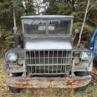

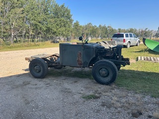

Well I finally couldn’t take it any more and have decided to give the old girl a face lift. It must of been a slow day on the base and someone must of said go paint the truck. Well that paint is all chipping off so I’ve decided to sandblast and paint it. I just purchased the truck a year ago from a person who had plans to swap the body onto a 2003 Dodge with a 24 valve Cummins. He lost interest and I bought it. The truck is all original with no rust so it seemed a shame to convert it. The grandkids and I have a lot of fun driving around the farm with the top off. I thought I would just share my restoration of it. Here is a picture of how I first saw it.

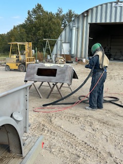

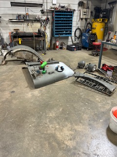

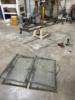

So I started stripping it down and painting

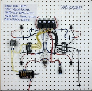

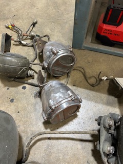

I’m going to delete a few lights and convert some of them to signal and brake lights with the help of a bunch of relays. Also going to simplify the lights by adding a normal light switch and wiring the signal lights to work like a normal vehicle. Can never remember what position to but the military switches to. As some might already know I switched the truck to electrical steering which is awesome and I have a 24-12 voltage reducer so with that I will convert my lights to 12 volts and install new wiring for them. I definitely am falling down the rabbit hole but!

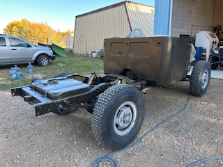

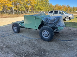

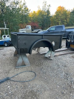

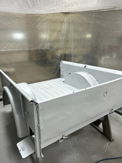

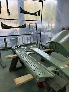

Got some more painting done and the parts are on the way from Midwest Military.
