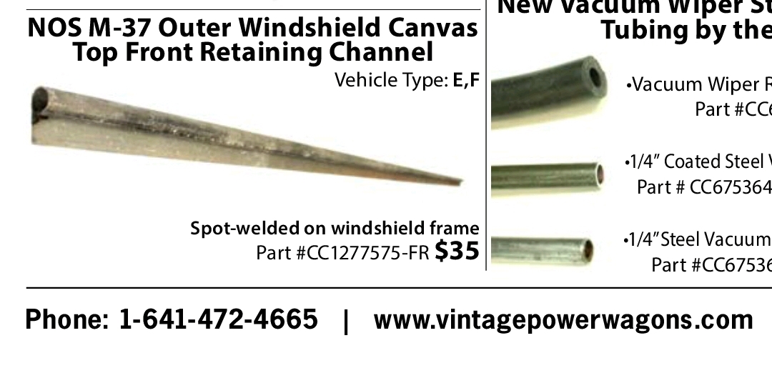

You need a windshield top front retaining channel.
Screenshot_20240121-125653_Hancom Office Editor.jpg (189.33 KiB) Viewed 7623 times

There should be a channel on the top of the windshield frame, the leading edge of the canvas top slides into.
Give John Bizal a call @ https://midwestmilitary.com/ for the parts that you are looking for. Great guy to work with.

Do you know if the hardtop still fits with this piece attached to the windshield frame?
Posts: 4354
Re: Canvas Top Parts
Most all hardtops do not fit with the channel loop in place. I also have a spare set of the soft top horizontal pieces 2 each that sit up top. PM me if interested.

Rdinatal wrote: Sun Jan 21, 2024 9:59 am You need a windshield top front retaining channel
BugsandJeeps, if happen to reach out to VPW about the retainer I would like to know what they tell you at the time of shipping. :x
