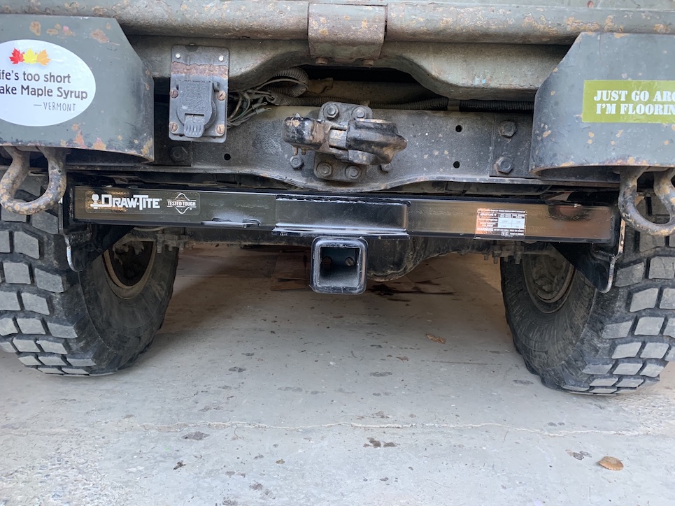

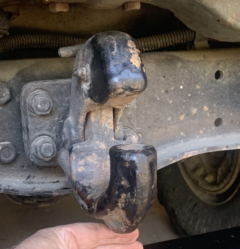

Hope these help. they are from when I was installing a receiver hitch on my M37. They are the best photos I happened to have of the Pintle hitch

Re: Pintle Hitch
The pintle doesn't get close to the tailgate when lowered.
That is, If you have the correct model.

PoW wrote: Wed Nov 08, 2023 5:51 am The pintle doesn't get close to the tailgate when lowered.
I wish I took a picture but this is from memory. It seems the mount is on the outside of the cross member making the pintle stick out an extra 1/2". Seems like it should be on the inside.

Looks like the previous owner assembled it incorrectly.
Seems like the mounting plate should be inside the cross member.
Re: Pintle Hitch
You're correct, it belongs inside the cross member.
At least the fix is just nuts & bolts, better than something done with a torch & welder...

Ok, thanks for the confirmation. 4 bolts, cotter pin, big nut! I can do that!
