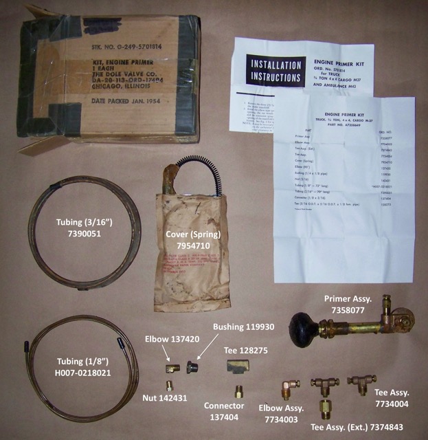

slk wrote:Does anyone have any pictures of the entire pump and lines to where they go. Where it is mounted on the dash, and how it connects to the carb or intake??
Thanks
Steve
Here's an old thread with a series of good detail photos by Storm Stevenson (who sadly passed away in April 2019, his forum name was "52 M-42") showing the primer installation on his M37.
http://www.g741.org/PHPBB/viewtopic.php ... 795#p41795
Here's a photo I posted years ago (seems to have disappeared when the image hosting changed) that shows the kit contents with individual part numbers.

The manual priming lever on the fuel pump is only going to push fuel into the carburetor float bowl, and even with a full bowl, the slow speed jet and choke can only enrichen the mixture so far. The cold weather priming pump injects gasoline directly into the intake manifold, making the air/fuel mixture even richer going into the cylinders when the engine is cranked over in cold temps.
