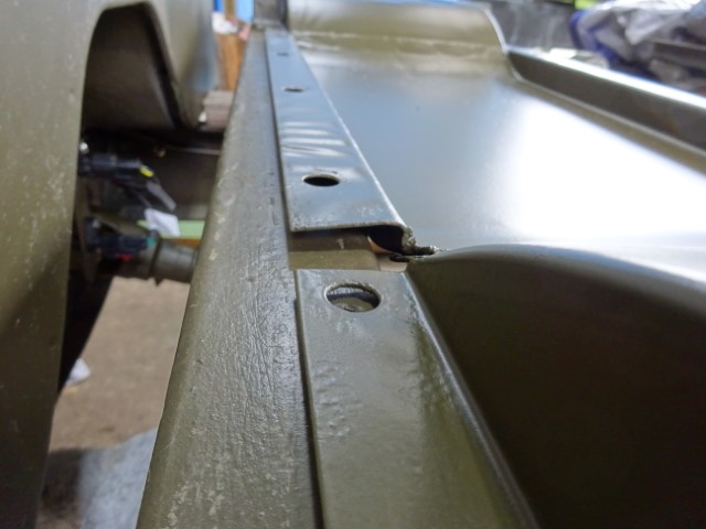

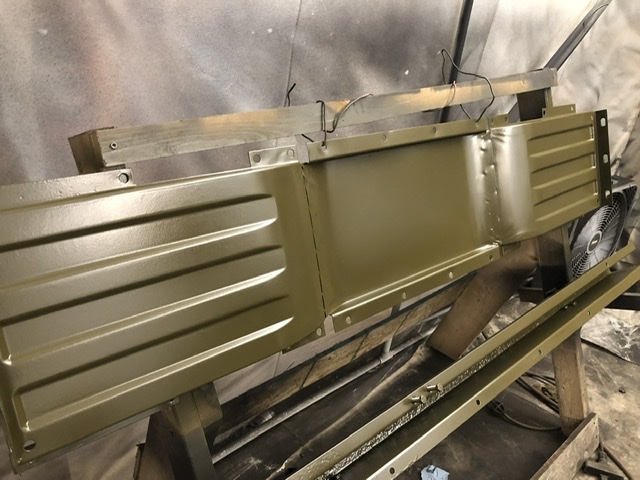

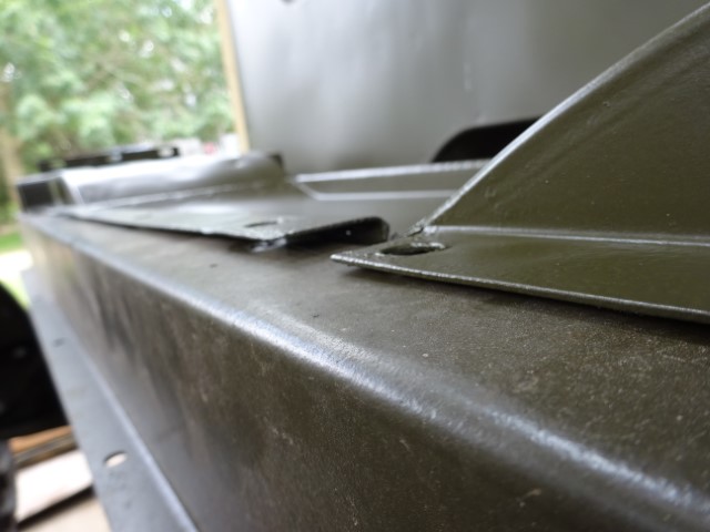

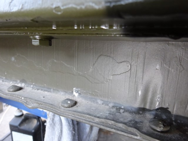

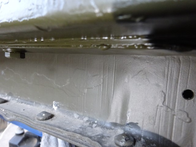

I am putting the tool box floor on, and have run into a "thing". looking at the pics, you can see that the center section is about 3/16" lower (pics are of it upside down) than the outer portions. When I took this apart, the floor was totally rusted out- I found a replacement. All this happened years ago so I do not remember if there was something there to take up the gap. Anyone know?

Looks about right. When you add the strip caulk and tighten down the bolts there will be no issue.

Tough to see but my tabs were offset too.

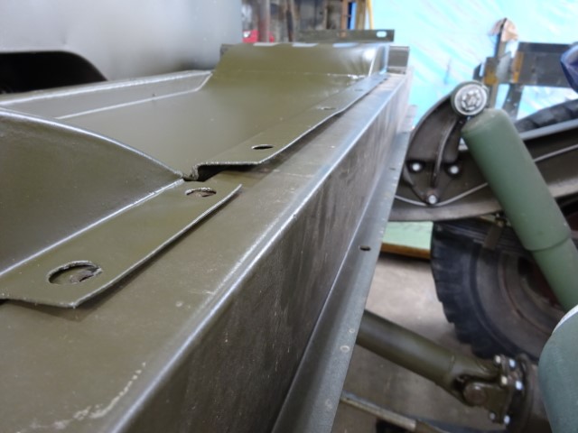

I found some 1"x1/8" bar stock laying around the shop, and made a couple of fillers. Painted them, seam sealed them and everything fit great.

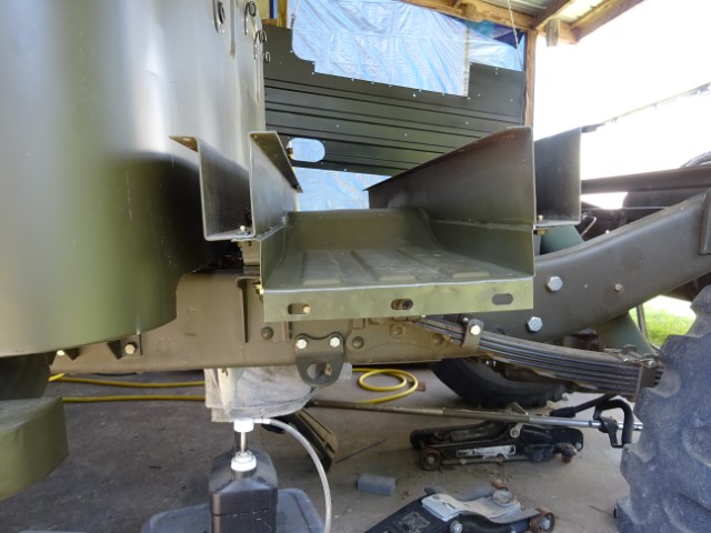

Did you bolt the toolbox to the frame? I think you want them divorced for flexing.

greeno wrote:Did you bolt the toolbox to the frame? I think you want them divorced for flexing.
No, it just looks that way in the pic- attached to the crossmembers (for the bed)

Indeed! I'm getting old...

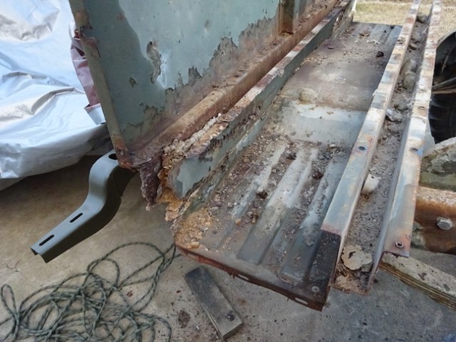

Just for fun, here is the "before" pic. had to replace the floor and both rails.
Re: tool box floor questions
Mine was bad, but not that far gone!
