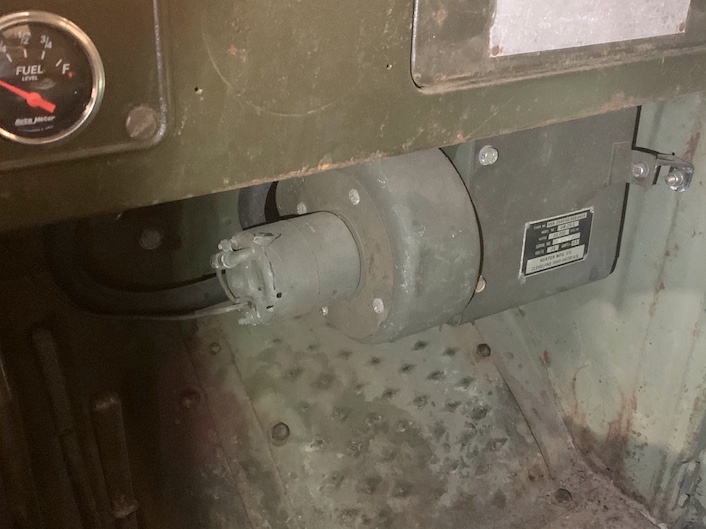

I have what I am told is a MUTT heater (but I have no idea), It takes heat from a coolant loop coming off the rear of the engine. It was on the truck when I got it. Seems like a nice fit, looks-wise for the truck. Installation appears to be fairly straightforward: run the coolant line to it, run the return back, hook up power and a switch.

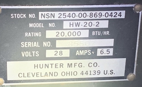

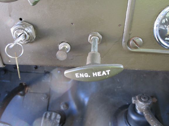

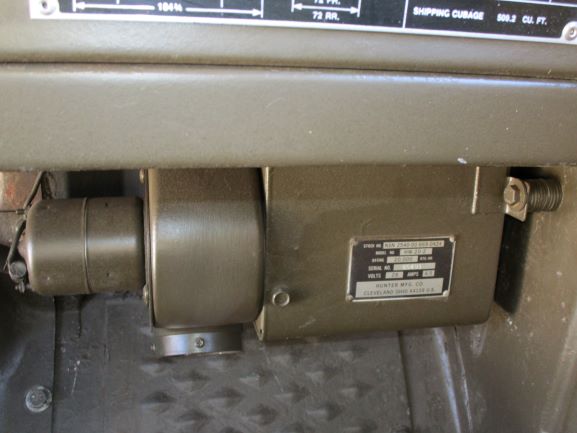

John is correct-that's a MUTT heater. I also run it (below). 20,000 BTU, does fine unless you're in really bitter cold weather.

Gary - Is that knob labeled "eng. heat" how you control it? If so, is that an electrical switch or a louver to cut off air flow?
My set up had no louver. Previous owner had converted to 12V, and just ran my fan off a 2-position pull switch. for high and low fan speed (which he left on high all the time, since running a 24V fan on 12 V was already slow). That switch failed, so I just temporarily replaced it with a toggle switch.
Since I'm converting back to 24V, I'm wondering if I'll want to regain some sort of adjustment on the heating beyond just on/off. I found that VPW sells the old style pull switch that was in there, but it says it's rated for 12V. Looking for good options for my control. I guess I could find a 3 position rotary or a SPDT center off toggle switch and wire in a resistor on one of the "on" positions, but thought I'd ask if you or someone had a better method.
Also interested to see if you have a defroster set up or not. I do not, but I haven;t been running much in the colder weather yet (I have the "Arctic Top", but almost no seals around my front and side windows at present, so there is a good breeze in the cabin. Once that gets sealed up, I may want to look at something to help keep the windshield clear. I may go with something simple and easily removable, even if it doesn't look "correct" and just take it out for non-winter use.

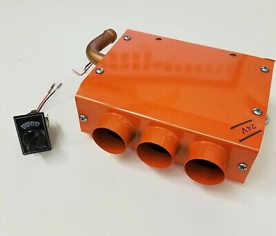

This unit is available on-line and seems very straight forward. Water circulated with a switch for 24v. Reasonably priced.

Do you have a link or a name so we can search for it?investig8 wrote:This unit is available on-line and seems very straight forward. Water circulated with a switch for 24v. Reasonably priced.

I too have the MUTT heater, Sam Wiener in Ohio must have bought everyone the Uncle Sam had, I think they still offer them? Cable Garbee's webpage has the complete install also.

@ John, that pull cable goes to a Ford-style manual heater control valve that I picked up years go, similar to this one:
https://www.amazon.com/HVAC-Heater-Cont ... 2555&psc=1
Pulling it opens the flow of coolant through the heater core. The little button next to the T pulls out to turn on the fan. They make the valve in 5/8 or 3/4 nipples depending on what you have (mine are 5/8).

Thanks for the healthy conversation... The unit I posted the photo is manufactured in Italy. After the discussion, I'll pursue one of the recommendations... not so certain about the one I asked about.
