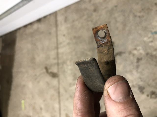

Fair point. Here’s a pic. The ones at Pegasus have holes on each end I was looking for a match to this:

Oh, now I see, you need the "hooks" to hold wires and such. I think your best solution would be to get the lightweight ones, and cut off the end of the look with the hole, and they would approximate the old OEM ones. I am away for a week from my home and would post a pic if I could. Let me see if I can find a pic of what I mean. NV
maybe you can make this work thus:
https://www.pegasusautoracing.com/produ ... oduct=4350
Murf

piece of metal, drill a hole, then black Platsti-Dip.
