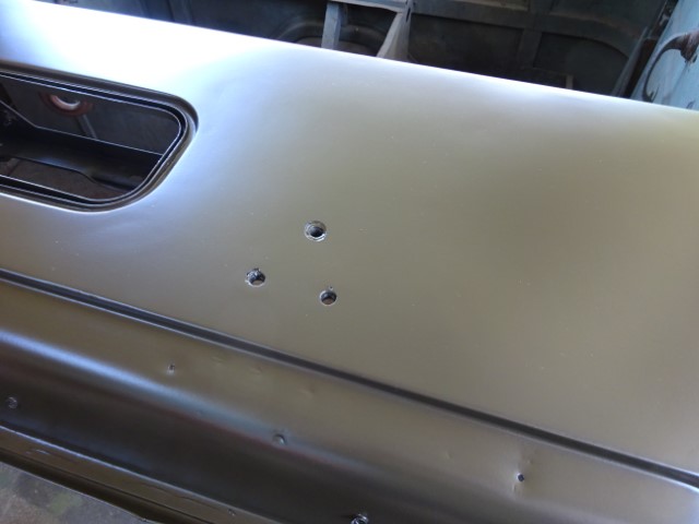

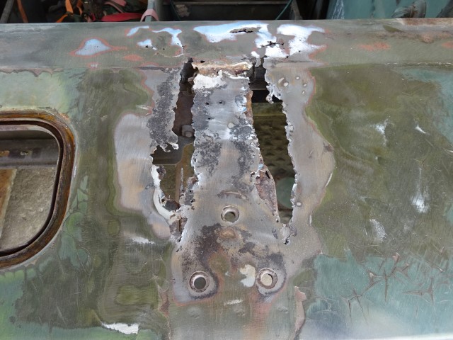

Getting ready to reinstall the hood hinges and was wondering if anyone has installed these with something between them. When I took them off there was nothing but rust there, pretty sure the factory put nothing (not too sure there was even paint). Kind of wanting to put something- just don't know what.

Mine are metal on metal-never considered putting anything in between, and I don't recall any material going there in any of my manuals.
Re: What to put between the hinge and the cowl (hood)
nothing on mine either, just treat like any other rust prone spot, brush down to good metal, some anti-rust treatment, some primer, paint, and bolt it back together. On my truck, there was surface rust up under the dash, where I couldn't clean or paint, so got some Cavity Coater, which is spray on wax-like coating to inhibit rust in hard to reach areas, KBS coatings has all sorts of metal treatments. I spray it where I can't get to, like inside my doors, etc. HC

Paint.
Nothing on mine either.

I have a lot of paint there now, just didn't want this to happen again

wow! rust rust silent enemy!
nice job done!

That rust has nothing to do with the hinge mount/screws. What you have pictured is the common cancer caused by the use of the felt strip on top of the support(s) underneath and sandwiched between the cowl sheet metal. I think the manufacturer was looking for the material that could hold the most moisture for the longest period of time when they installed it as an insulator. :roll:
BUT DAMN NICE REPAIR !
