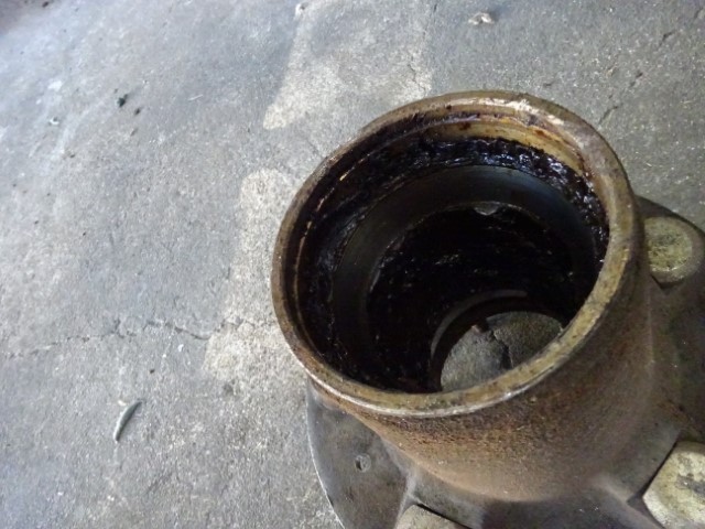

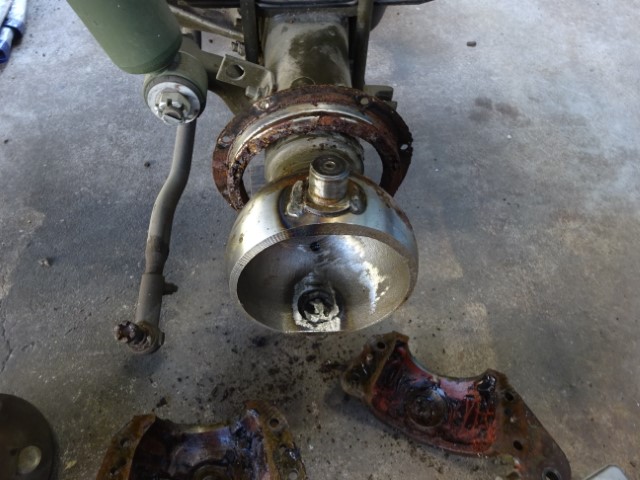

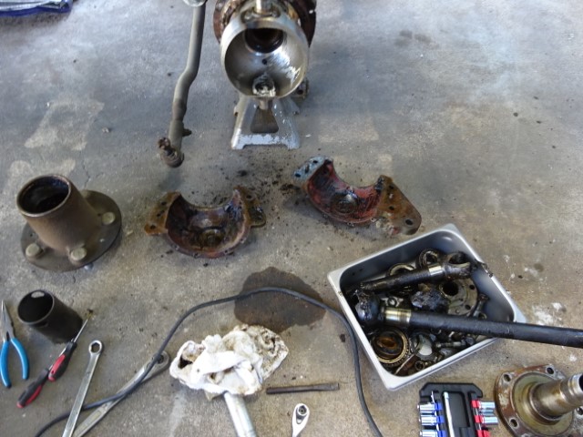

tore apart my passenger side front knuckle. first thing I found was there was no inner seal on the hub-not wore out- not there not installed! I got the entire knuckle apart and am now wondering how to remove the felt seal flange, and more importantly, how to install the new one without bending it
Re: how do you remove front knuckle felt seal flange?
I figured it out- just keep on twisting 'til it clears the axle tube!

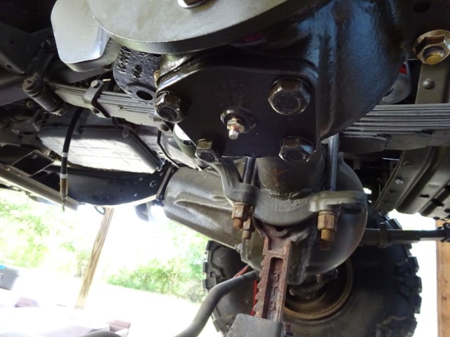

I went with bearings top and bottom, and did the lower grease fitting mod. My old lower bearing was almost dry- hard to get grease down there from the top.
