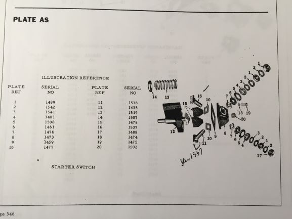

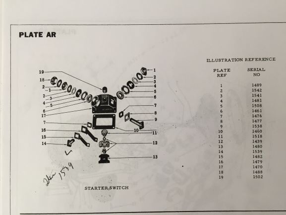

Re: Anyone rebuilt a late model 24V starter switch?
Hi Ashyers,
Good thing you found that leak!
Here are the pictures from my parts manual. Looks like there are two types of switches that are different in how they mount to the starter. To my eye they appear to have a few differences with regards to the internals, but they operate the same. I think the later style has more insulation around the switch contacts, for one.
Rob,
Thanks! The upper switch is the "late" switch and the one on my starter. I wonder if parts 11, 12, and 16 are available anywhere...
I chose not to pull it apart since I'd likely destroy the gasket, 9.
I'm curious about part 20. It's just a plug from what I can tell. Wonder if flushing the switch through there with some good contact cleaner would be beneficial?
Either way, need to sort out the fuel line today.
