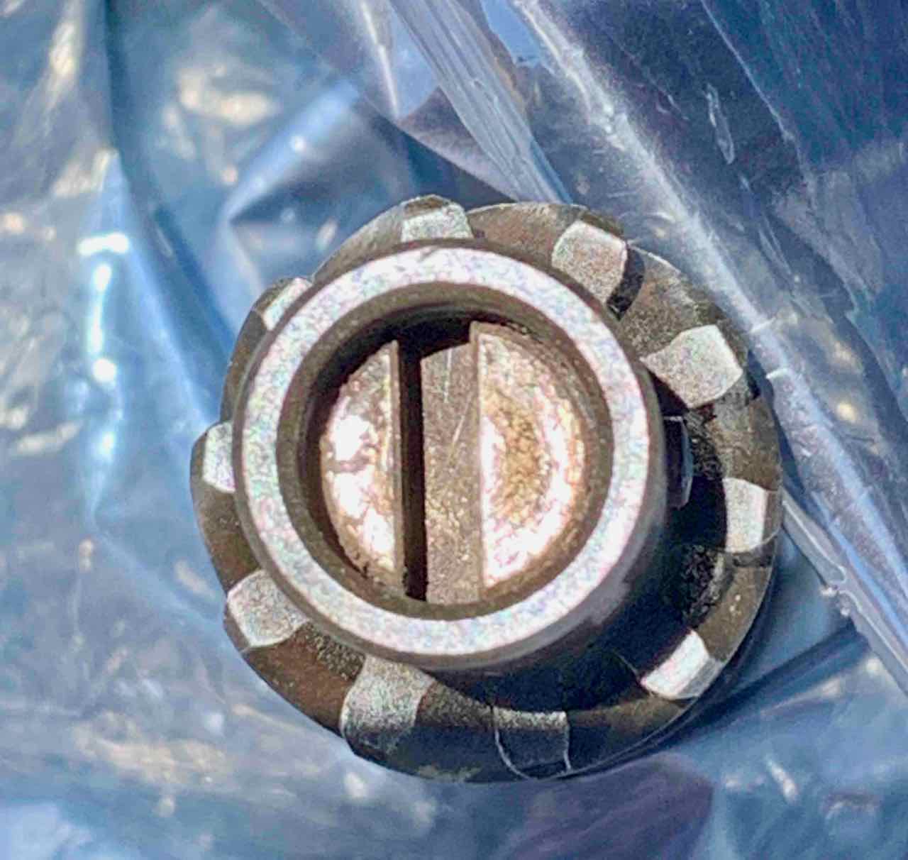

I purchased a new Melling oil pump for the M37. Box said part number M37. Inside was a civilian pump which is different than the military (T245A) engine. Pump was returned. See the pic below.

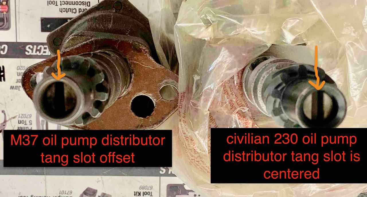

I contacted Melling pump technical services with pictures of both the REAL M37 pump and the civilian oil pump with pics.
Their response was this:
Sorry – The pumps that Melling would offer are the M-37 & the M-37R which are the only pumps that we would offer for the Dodge 230. You may want to try EGGE machine, ph. 866-586-3443 they offer hard to find parts from the years 1900 – 1980.
Just want to warn folks with T245 M37 engines that they may receive a civilian style pump (center distributor tang machining) in the box labeled M37.
- M37 oil pump drive gear and offset distributor slot (1).jpg (118.57 KiB) Viewed 2189 times

That's good info with pictures for those who are not aware, Outpost-thanks for posting them!

Midwest Military has NOS, correct, pumps for the M37 engine.

you can just swap drive gears as well

John, what company made the correct M37 oil pumps? I sent pictures of both oil pump drives, centered and offset. The Melling technical group never saw an offset tang drive. Hmmm....... Did any company make higher volume pumps for these engines ?JBizal wrote:Midwest Military has NOS, correct, pumps for the M37 engine.
