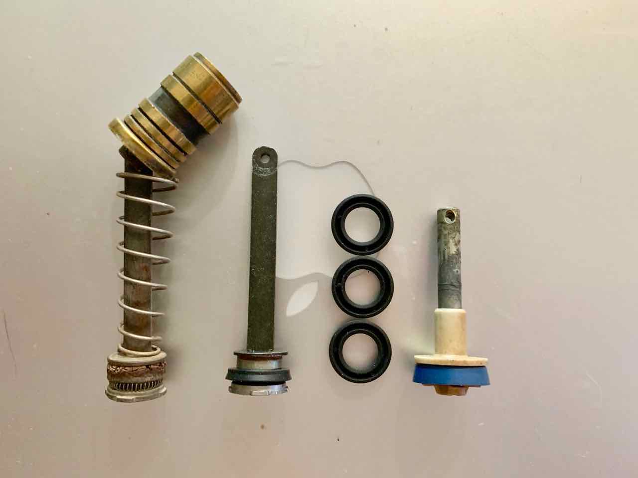

Has anyone performed a mod for the leather original Carter Ball & Ball carburetor accelerator pump to address today's oxygenated fuels?
Left to right: 1) original leather accelerator pump seal 2) Viton with viton oring and U cup. 3)Carter Thermoquad Viton accelerator pump.
Been running Carter TQ carbs on most of my Mopar V8 engines. The rebuild kits come with alcohol resistant U cups for the TQs. These accelerator pumps on the Carter TQ carbs seem to last forever. Figured I would try a conversion on the ETW1.

. I live out in CA which may have the poorest fuel available from the standpoint of older engines. Here's what I've found with some of my older vehicles, including the M37. Run modern rubber fuel lines, anything older than a few years will fail alarmingly quickly, usually near the clamp area. This isn't an issue in the M37 unless you modified it, but the vent lines should be checked. Leather accel pump seals work well as long as the carb is used regularly. If you run the float bowl dry they're done. Watch the switch from Winter to Summer gas. The modern stuff seems to boil pretty easily in the fuel pump and if you have Winter gas in the tank you may see some vapor lock issues as the weather warms. The alcohol in the fuel will "clean" your fuel system. If there's any gunk it won't be there for long, it's headed to your jets. That said my truck runs well on the crappy 87 we have out here and has had no fuel system issues for some years. I do drive it a few times a week, if not daily. This likely helps.
As far as the pump seal watch the tension on the seal. If it drags it's going to effect pump function. I had an issue with a reproduction pump seal that was too tight and effectively disabled the pump.

Yes, since the pump operation is on vacuum, if it drags too much in the chamber, it will affect the performance.
