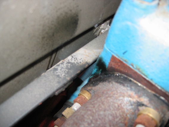

- oil splashing firewall from area of exhaust pipe

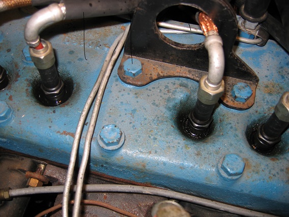

- oil puddles around some (most) of the plugs

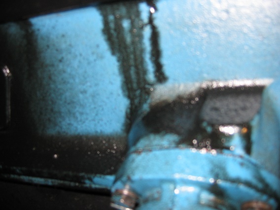

- oil puddle under the exhaust tailpipe

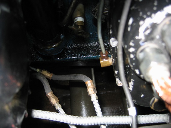

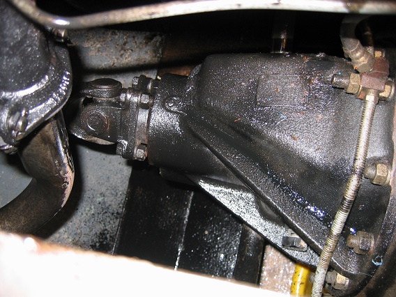

I checked the oil to see how much I had left and the dipstick showed full but it was oil heavily diluted with gas!
The last time the truck actually ran (poorly) before today was in May when I put it into the garage to start on the ignition problem. At the time it was running rough with a sooty exhaust, but nothing like what it was doing today.
Now I know that I am facing a more substantial repair than I was before but can anyone tell me what just happened???
If this was a head gasket, my understanding is that I would expect to see white smoke. It appears to me that the oil was forced out through any possible orifice under pressure and that gas is somehow getting into the oil, increasing volume and therefore pressure.
Can anyone shed any light on what I am facing now and what the next steps might be?

That's a lot of crankcase pressure to do that. Cracked block? I would suggest a leak down test to see what is going on. And replace the fuel pump diaphragms with modern materials to stop the intrusion of fuel into the crankcase.

Fuel in the oil is nearly always caused by a failed fuel pump diaphragm.
I would suggest reading this for the leak down test. Very valuable diagnostic tool. Do all 6 cylinders unless you run into a bad problem on the first ones.

I run electric pumps so in my experience all the gas in the oil can be attributed to flooding. the Douglas valve port is at the lowest point of the intake. gas will flow from the manifold into the crank via the Douglas valve (PCV). with every vacuum pulse (with the choke closed) the carb will pump .25 oz of gas in to the manifold. high float....
the grey smoke was from the flooded manifold washing the coke out of the combustion chamber and exhaust
the oil pumping out of your block is easily explained..... if the fording valve got closed
