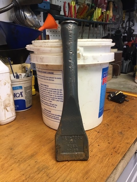

Hey there folks,
I did some research looking for Bead Breakers that Truck Mechanics use.
Spoons are the best way to go, but they are pretty expensive.
I did manage to find a Hand Tool for this job.
This is the Ken Tool, T 26 A
It was 40 bucks to buy it here in Ontario.
I used it and a 25 LB sledge to remove a 1951 Goodyear tire from the original BUDD rim.
The tire came off in one piece, the rim was left perfectly in-tact.
It tool a heck of a pounding, but it beat my first attempt using my F150 to drive over the edge of the tire, then cut it off with a reciprocating saw.
Other guys have tried angle iron, or steel bars as well.
This is curved for the rim and works its way between the bead and rim.
Sure feels good when you pull the tire off let me tell you.
- Ken Tool Bead Breaker 2.jpg (109.05 KiB) Viewed 2770 times
