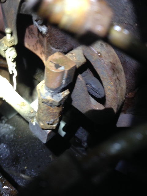

Found it looks like 1/2 my trucks are missing it only the most original truck still has it

Post by marc8_2 »
This that it looks like new

Post by marc8_2 »
It hits the pipe to stop heat valve

Post by isaac_alaska »
marc8_2 wrote:Found it looks like 1/2 my trucks are missing it only the most original truck still has it
I think I remember seeing something like this on my WM300 civvy power wagon. Always wondered what a valve was doing in the middle of the exhaust pipe
