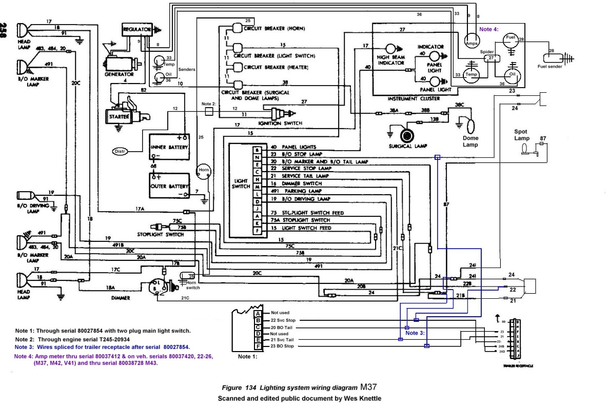

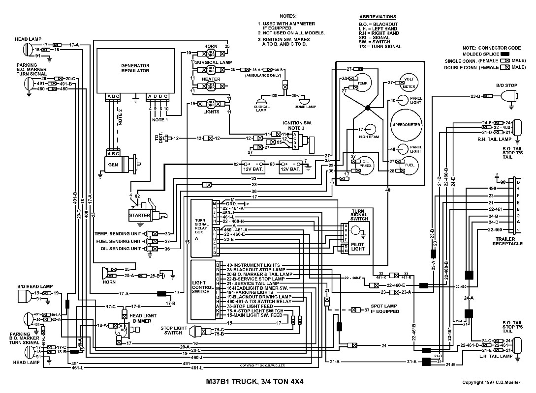

Also, what manual/where could we find the wiring schematic for this?

50-55 M37 series w/o turn signals
M37 only sm.JPG (228.27 KiB) Viewed 3207 times
50-55 M37 series w/o Turn signals
57 & up M37B1
57 & up M37B1
M37B1 wiring dia. sm.JPG (226.09 KiB) Viewed 3207 times
57 & up M37B1 series

Wes on the job again! I recalled this schematic in an old post, and I beleive Wes being the postmaster on that one too....

Many thx my friends, that is the right diagram i needed, and now back to bringing another old milly truck to life :D thank you guys again, and if i can figure out how i will post some pic's soon !

Thanks for that! I was looking all over for the wiring diagram that was printable. Everything you find on google is way to small to see the labels.
