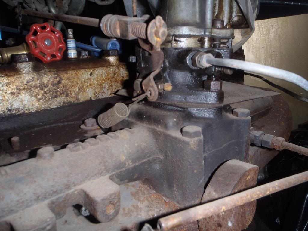

Re: intake manifold for 251 c. i.
the military intake has the lowest profile of the three 251 single "down draft" carb intake manifolds that I"m aware of.
this is a stock m37 manifold, low
medium
high
medium
high
Thanks for the info Terry and RMS.
Went out and looked at the intake manifold on the 251 Chrysler Windsor.
Sure enough, the top of the manifold where the carb attaches is almost
level with the TOP of the head. 2" higher than the joint between the head
and the block. Thanks for the pic's.
I guess I'll be looking for a military 251 intake manifold.
I'll try to post some pic's of my set up. It works just fine
but the rinky-dink air cleaner looks out of place.
Jerry
Here's a pic of the 251 Chrysler Windsor intake manifold installed on my M37.
Note the straight edge on top of the head is the same height as the top of the intake
manifold. You can see this maniflold is at least 2" higher than on the pic's posted by RMS.
Problem solved but now I need a military 251 c.i. manifold with the lower profile.
Anyone have one for sale???
