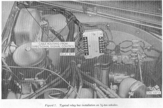

The 1963 MWO for the turn signal kits, with the older, non-solid state flasher, shows the "typical" location for the 3/4 tons is on the inner left fender. The text accompanying it states: "Locate distribution relay box 8683529 in the most convenient place in the engine compartment making sure that leads from the directional control will reach the relay box terminals."
- 3/4 Ton Location-Typical, circa 1963
- MWO Turn Signals_3Qtr Ton Installation-Typical (1963) (Small).jpg (46.77 KiB) Viewed 1372 times
