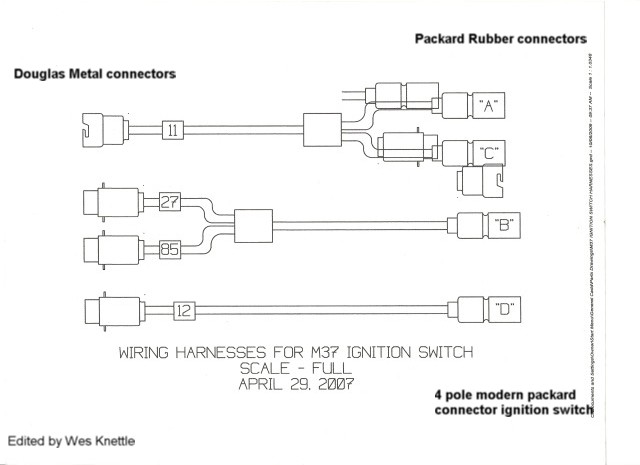

hi,can anyone out there tell me the order of wires on the switch ??? my ignition switch has no number tags on the wires !!!,so if i was looking at the back of the switch what would be the numbers clockwise ?? so i can then place new tags,thanks to any and all who can help me with this,nutsfor59

Here is a digram of the switch. Hope this helps you out.

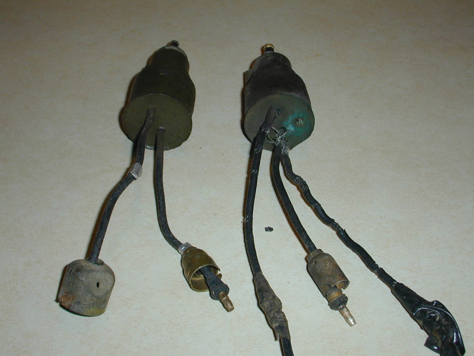

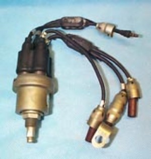

Re: dodge m37 ignition switch
That's a M37B1 switch. The early switch did not have those rubber sockets on the back.
Early Douglas connector 2 & 3 wire M series ignition switches.

Later Packard connector 4 plug switch with a Douglas adapter harness.
4 Post Packard sw to Douglas.JPG (36.73 KiB) Viewed 4985 times
Wiring the 4 pole Packard switch.
