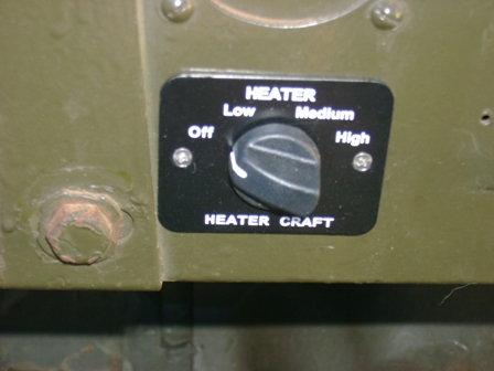

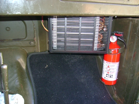

Pick my heater up from J.C. Witnees , nice small box heater gives the passeger lots of room and at 20000 btu's it will smoke your Butt . see my pictures, not the real deal but it works dam fine!
- control switch
- m37.heater.1.JPG (103.88 KiB) Viewed 1435 times
- inside heater
- m37.heater.2.JPG (113.84 KiB) Viewed 1437 times
