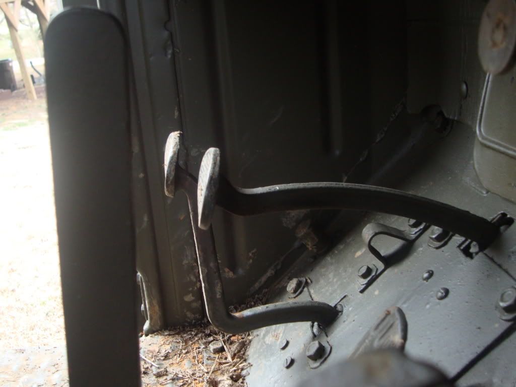

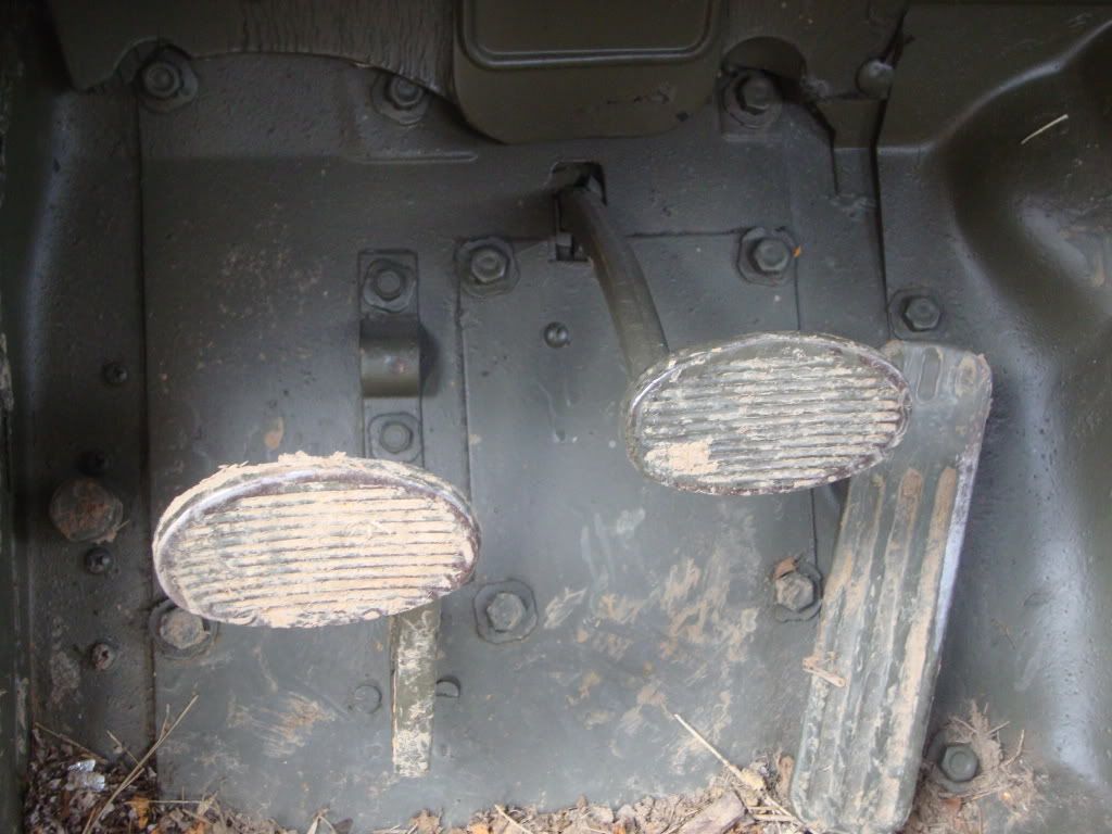

Wow.. Thanks for all the info and ideas... Well i dont have blocks behind my floor board, but i see how it would stop the clutch from coming back so much. See my clutch comes out about two inches further than my brake.
As i ponder on ideas myself i notice a bracket or something behind my clutch bolted to the floorboard. See in both pics.. what is that for?

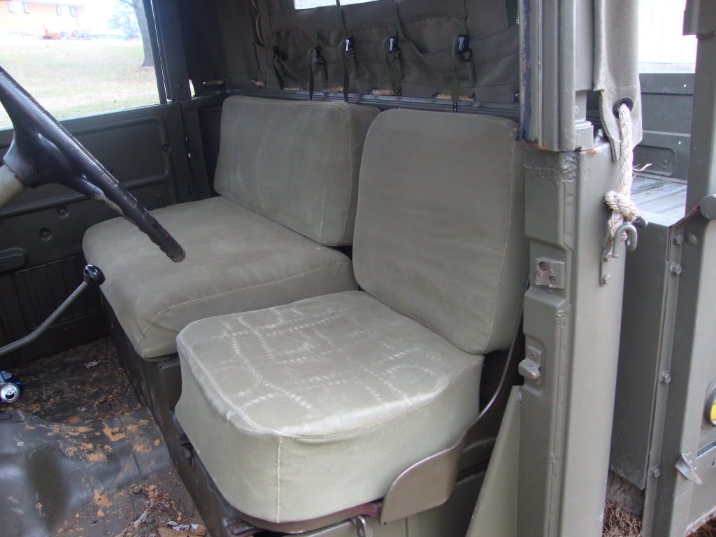

Now the seat.. Still im thinking its stock.. Got lots of good ideas about that. See its back as far as it will go. ill come up with something.

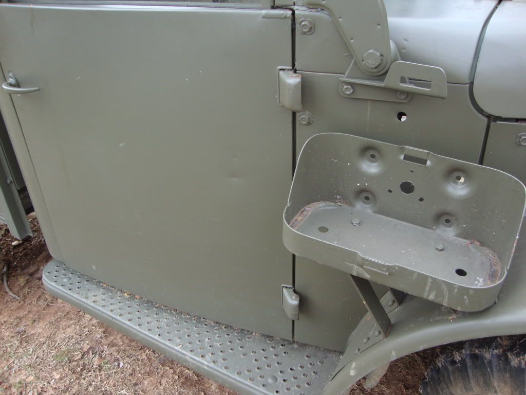

How many of you have a dent in your door, because of your jerry can? How can i stop the door from opening so far? This is a real straight truck... I hate to see these things happen, even though i dont baby her.

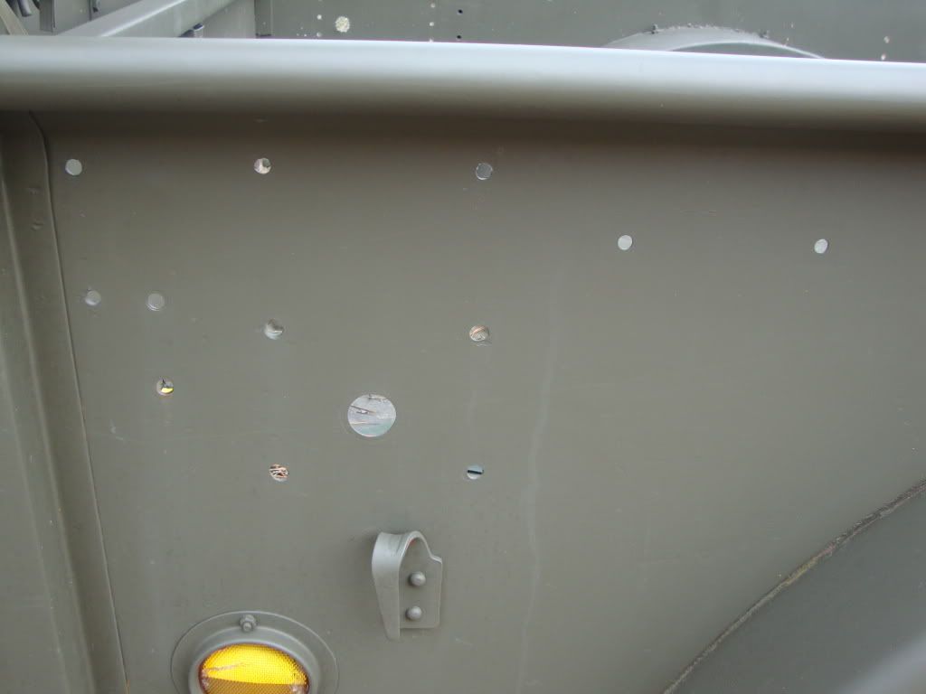

Red paint under odg, im thinking a bush truck for the firedept. Maybe explains some of the holes in the bed.
INDEED, IT SEEMS STRANGE THAT THE CLUCH PEDAL RETURNS SO FAR BACK. THE BRACKET BEHIND THE CLUCH PEDAL, I THINK IT IS A MAXIMUM TRAVEL "STOPPER". I MY TRUCK WHEN THE CLUCH PEDAL IS FULLY PRESSED IT ALMOST TOUCHES THAT BRACKET. AS FOR THE JERRY HOLDER BEND, ON THE INSIDE OF THE DOOR, WHERE IT HINGES, IT HAS AN ARM (ORIGINALLY, IDK IF IT STILL EXISTS IN YOUR TRUCK) THAT ARM LIMITS THE TRAVEL OF THE OPEN DOOR. THE ORIGINAL DESIGN HAS A RUBBER PIECE ON THE INSIDE OF THE DOOR AT THE END OF THAT ARM. APPARENTLY, YOU MIGHT BE MISSING THAT RUBBER PIECE. I WAS MISSING THAT, AND AS OPPOSED TO GET A NEW ONE, I CUT SEVERAL ROUND PIECES OF AN OLD TIRE FLAP, AND SKEWERED THEM ON THE END OF THAT ARM, PREETY MUCH LIKE THE LEATHER HANDLE OF THE KA-BAR KNIFE. THIS WAY I COULD ADJUST EXACTLY WHERE I WANTED THE DOOR TO OPEN TRAVELWISE BY ADDING OR REMOVING PIECES. WORKS GREAT. AS OF THE HOLES IN THE BED, THE ONE YOU SHOW IS FOR MILITARY RADIO EQUIPMENT AS FAR AS I KNOW. YOUR SEAT SEEMS TO BE MILITARY, BUT I AM NOT 100% SURE. MAYBE OTHER FOLKS HERE MIGHT HAVE A MORE KEEN EYE ON THIS SUBJECT.
It appears as though you do have the blocks mounted behind both the clutch an brake pedals, or at least the screws from where they were mounted. The two flat head machine screws in the floor board directly below the hole the clutch pedal goes through are not original as far as I know. there are also two screws in a similar location on your brake pedal. Perhaps the block of wood for the clutch pedal was removed or rotted away, but the one for the brake is still there explaining the difference in pedal height.
