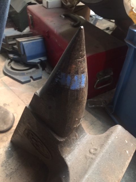

The old vent that was with the truck was also rusted a good bit. It might could have been worked over and used, but some years back I had purchased an NOS vent to use. I cut off all the sides of the old vent only leaving the top cover. I have this flexible moldable plastic tape that I used to bend in the curve of the inside of the vent top. I took this flexible tape to the point of my anvil and marked that spot with blue tape the place on the nose of the anvil that matches the curve of the vent top.

Here is a closeup of the curves I created. The bottom one was the first one I bent and played with it too much and might have to make another one. The next step is to cut the metal pieces up, jig them together and weld them.

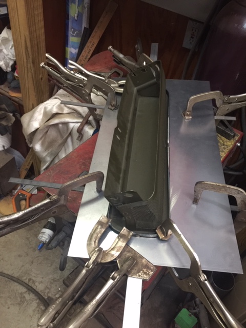

Time to take on cutting the center out of the metal panel. Since I want it to be a close fit between the flange and the panel, I used the small Dremel type air tool. This took quite some time as you have to make many passes over a cut before it goes through. Plus, there is the time to change the small disks. I used about 5 disks for this cutout. I could have used the plasma cutter but using that you can make a big mess if you can’t control the placement of the jet.
Once the centerpiece was out there was lots of grinding still left to do to get the flange to fit correctly. I picked a new flap disk for the hand grinder and that worked well. It was aggressive enough to cut down the metal but still allowed control. There are a few gaps in the fitment, but I am liking it.
I placed the NOS vent into the opening, and it looks good. It will not be flush with the cowl but everyone knows there is a vent there so I will be okay. Now I have to figure out a way to clamp the flange in place for tack welding.

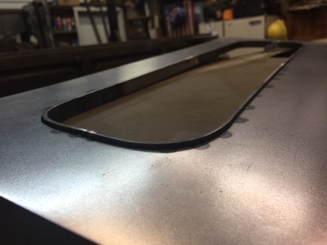

Came back to it the next day and it took some time to figure out a configuration to clamp it in place so the flange was even all around. The vent caps have a slight curve to them to match the slight curve of the cowl. I was pleased that once clamped in place the sheet metal had that slight curve in it. I tried to use all the clamps in the shop. I even dug in a couple of drawers to find a few extra! :lol:
Here it is tack welded in place
After finishing the bead – a small amount bled through and will have to be ground a bit. So far I am still pleased with the result.
