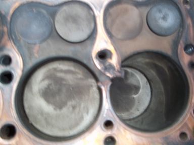

Thanks for the advice and well-wishes, guys. Here's the rundown:
I tore into this today, took a couple of hours dodging thunderstorms in the area. Long story short, the gasket blew between #5 and #6, and appears to have been working toward that finality for some time. I haven't had time to inspect the block in detail yet, but the spark plugs aren't fouled nor oily, and the cylinders appear to still have the cross-hatch pattern intact, leading me to believe that the engine hadn't run too much after the last rebuild. All of the valves appear to be in good shape too. I am concerned at the extent of the head gasket damage-also noticed that the bolt hole area on the gasket is wallowed out. I suppose that the back-and-forth pressure when on the compression stroke could do this but am not sure.
Anyway, here's a look:
- Top of block and gasket-overhead.JPG (30.37 KiB) Viewed 2920 times
- Blown head gasket-view 2.JPG (20.38 KiB) Viewed 2920 times
- Headgasket-blown between 5 and 6..JPG (15.87 KiB) Viewed 2920 times

Re: So now, to the blown head gasket...
It looks like it was leaking some between No 4 and No 5 cylinders there by the valves too. I would think the head is warped and probably not re-torqued after the gasket was replaced last time. Hopefully the block is straight. The area between #1 and #2 cylinders look a little iffy too.
Joe
Joe
And between valves 2 and 3 cylinders. The not retorqued scenario seems pretty likely if the head and deck are within spec of flatness. Rebuilt. Run a small bit and then stored. Never retorqued would do that.

Thanks guys,
Closer inspection of the photos confirms your findings. I felt that some of the head bolts came loose w/o much effort which could explain some of the leakage. I'm also happy to report that the top surfaces between cylinders remain intact, as John cautioned that sometimes that small area gets worn down when the head gasket blows and then the engine subsequently overheats.
I'm going to have the head work done in a couple of weeks. In the meantime I can replace my leaking freeze plugs and flush out the cooling system. I'll also spend some time ensuring the block top surface is straight. Of course, once I have it all re-assembled I'll change the oil and filter.
I have seen a number of these 230s gaskets fail between 5 and 6, never figured out why but that area seems to be where the 230's head gaskets let go most often. I have wondered if it had something to do with coolant not being able to circulate thoroughly at the back of the engine.
