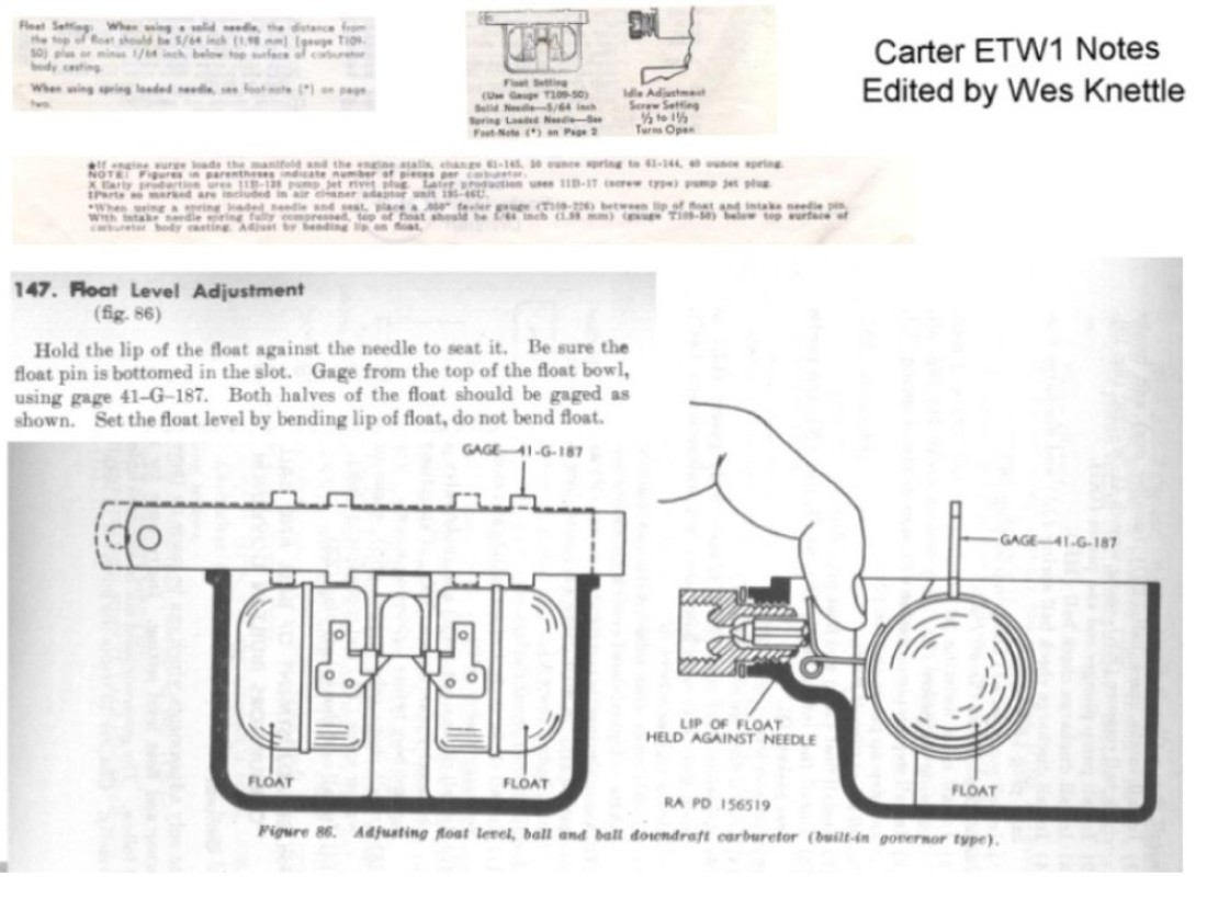

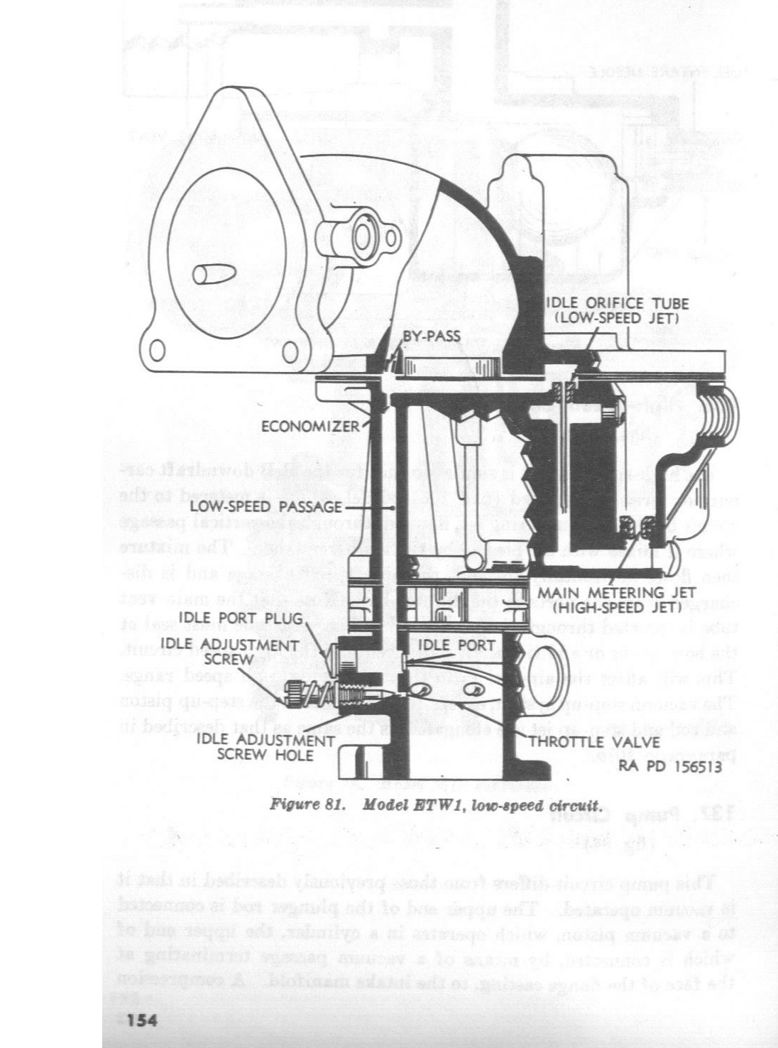

Re: Carburettor question
Generally speaking a minor lowering of the float level (thus the fuel level in the bowl) will not have a very noticable affect on idle mixture. The idle circuit can usually accommodate a slight flux in bowl fuel level but it will not tolerate restrictions in it's passageways, air leaks or damaged mixture screw tips and seats. A more common source of lean idle issues is a bad main body gasket that doesn't seal the top of the low speed passageway. Note the extra steps required when using a spring loaded float needle.
Here's a few helpful photos:
ETW1 Notes.JPG (126.84 KiB) Viewed 3834 times
