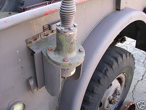

Would this be the proper location for a "Sugar Scoop" antenna mount on an M37?:
antenna mount.jpg (28.08 KiB) Viewed 1501 times
I am eager to get my antenna on and R174 hooked up 8)

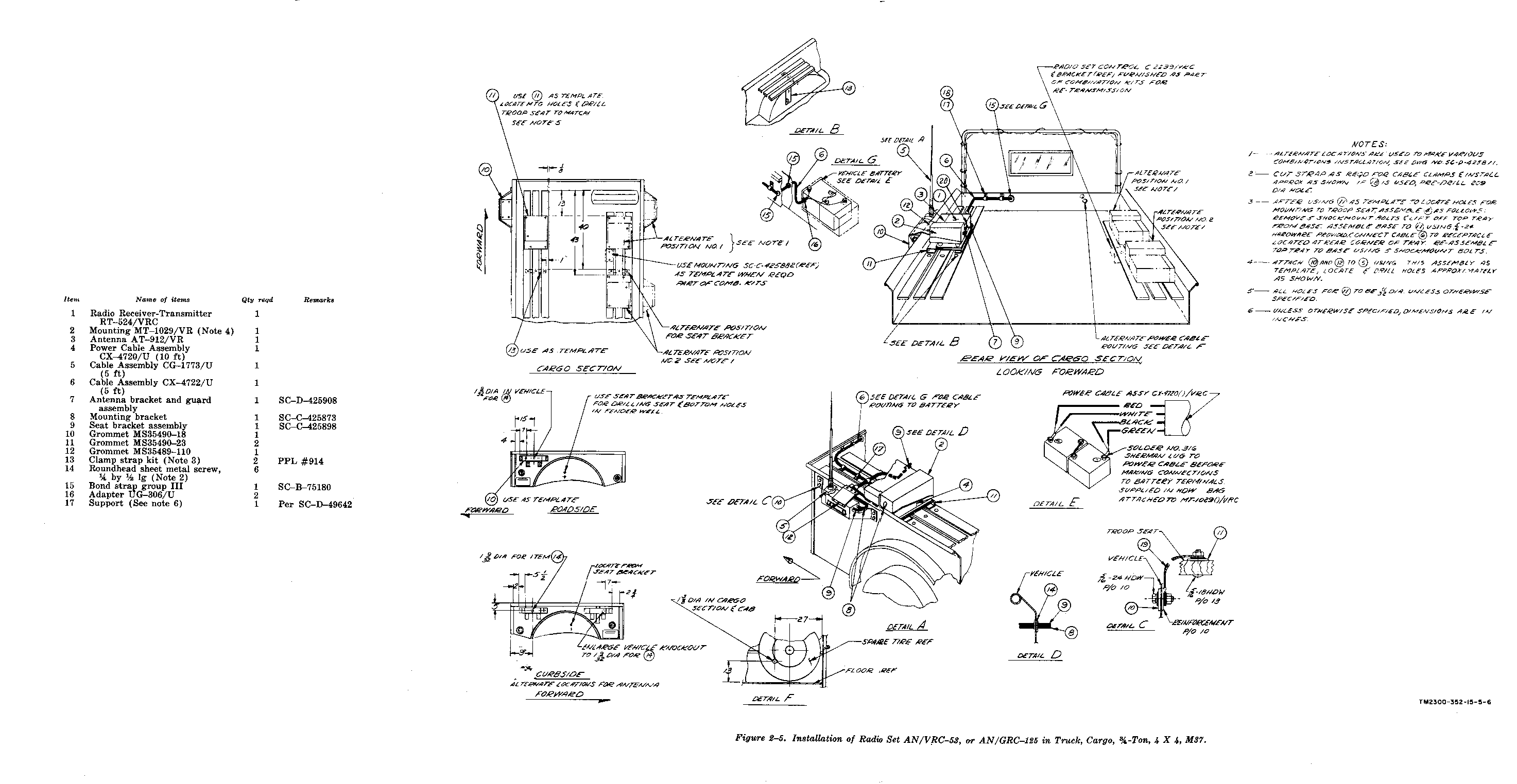

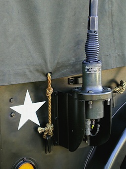

Ive been doing some research into this and came across this web site , http://www.nf6x.net/greenradio/tm11-230 ... 5/toc.html , that shows the manual for installing the radio sets on the M37,it shows TM 11-2300-352-15-5,I also have manuals TM 11-2300-352-15-3 and 2,all for installing different types of radio sets in the back of the truck,the mount changed around 1967 to the sugar scoop type,ive also attached a picture similar to one you posted and looks like the correct position to me,the manuals are a bit scetchy as to where it goes axcactly,but you will have to position the mount around where the cable comes out of the side of the truck through the knock out hole,to be able to fit it to the MX-6707 antenna matching unit.
I hope this helps and im sure others will have there input as well.
Regards.
Paul.

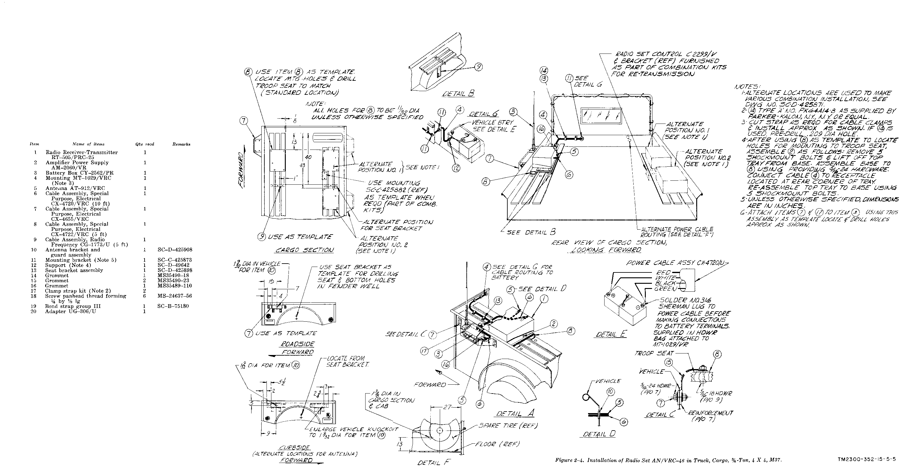

Re: Sugar scoop Mount
From Mark's page

Man Wes you have got the stuff !! Thanks for posting the drawings!!
It's not magic. I operate two of these forums and once you do it a few times it comes easy. :wink:
